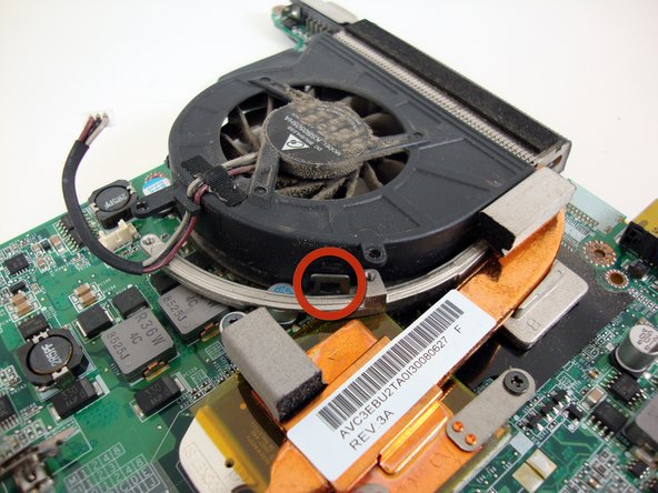

    • Locate the 3 circled clips holding the fan to the motherboard.
    • Pry each clip outward while applying upward force on the fan as shown.

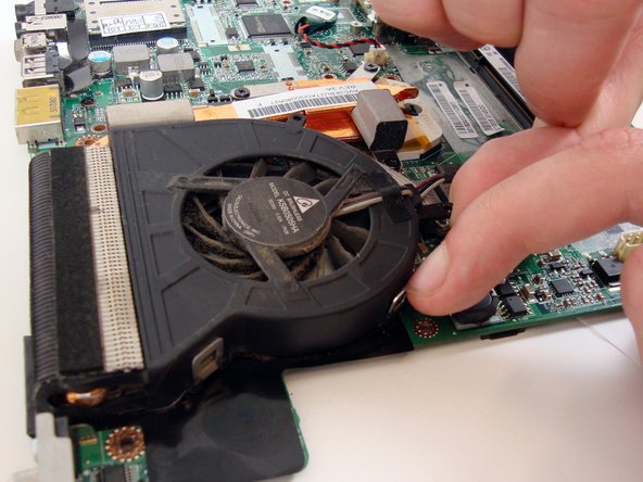

    • Carefully pull out the fan.
    • Note: replacing the fan is highly reccomended
    • Optionally you may clean the fan with Air + Q-Tips. To remove the blade turn the fan over and gently pull the fan blade from the housing.
    • If the fan is no longer operational, it may be possible to temporarily repair it by removing the fan blade and put a small amount of WD-40 on the pinion shaft hole the fan rotates in. A toothpick is a good applicator. Do NOT contaminate the motor area with any of the dust/grime that has accumulated.
    • Insert the fan blade and move the blades with your finger. It should spin freely and cog to a stop. Again this is a temporary fix!
