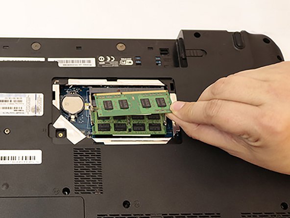

    • Push the two top tabs outwards and the top stick of RAM will pop up. Gently remove the stick of RAM by pulling it out.
  8. Toshiba Satellite L775D-S7340 RAM Replacement: crwdns2935265:08crwdnd2935265:01crwdnd2935265:01crwdne2935265:0
    • Push the two bottom tabs outwards and the bottom stick of RAM will pop up. Gently remove the bottom stick of RAM by pulling it out.
