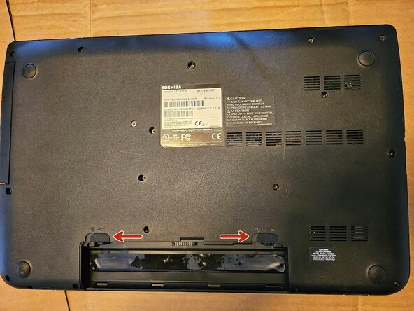

  1. Toshiba Satellite L75-B7270 Optical Drive Replacement, Remove battery.: crwdns2935265:01crwdnd2935265:01crwdnd2935265:02crwdne2935265:0 Toshiba Satellite L75-B7270 Optical Drive Replacement, Remove battery.: crwdns2935265:01crwdnd2935265:02crwdnd2935265:02crwdne2935265:0
    • Slide battery locks outward.
    • Remove battery.

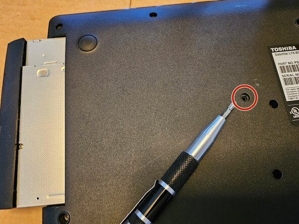

  2. Toshiba Satellite L75-B7270 Optical Drive Replacement, Remove optical drive: crwdns2935265:02crwdnd2935265:01crwdnd2935265:03crwdne2935265:0 Toshiba Satellite L75-B7270 Optical Drive Replacement, Remove optical drive: crwdns2935265:02crwdnd2935265:02crwdnd2935265:03crwdne2935265:0 Toshiba Satellite L75-B7270 Optical Drive Replacement, Remove optical drive: crwdns2935265:02crwdnd2935265:03crwdnd2935265:03crwdne2935265:0
    • Remove screw.
    • Slide out optical drive.
    • Model: UJ8E2 Parts number: G8CC00061Z20
