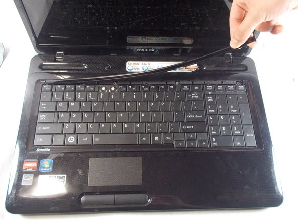

    • Use a spudger to pry under the corner of the thin piece of plastic located above the keyboard.
    • Once part of the plastic guard is up, continue to pull up gently until the piece pops off of the laptop exposing 4 screws.

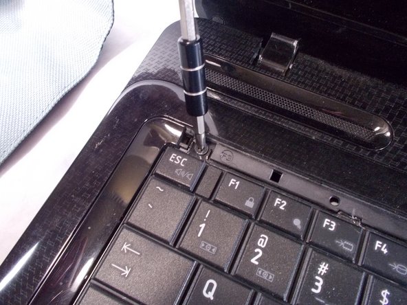

  4. Toshiba Satellite L675D-S7015 Keyboard Replacement: crwdns2935265:04crwdnd2935265:01crwdnd2935265:02crwdne2935265:0 Toshiba Satellite L675D-S7015 Keyboard Replacement: crwdns2935265:04crwdnd2935265:02crwdnd2935265:02crwdne2935265:0
    • With the screws exposed, grab your Phillips #1 screwdriver and remove the four 4 mm screws.
    • Make sure you do not lose them since you will need them to reinstall your new keyboard.

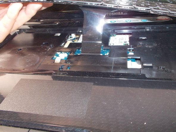

    • With the screws removed, you are ready to take out the keyboard. Lift the keyboard from the top and carefully pull the keyboard away from the laptop.
    • There is a thin connector that wires the keyboard to the motherboard. Pulling on this to hard could cause damage to the clip that will connect your new keyboard to the motherboard and require you to purchase a new one.
  6. Toshiba Satellite L675D-S7015 Keyboard Replacement: crwdns2935265:06crwdnd2935265:01crwdnd2935265:02crwdne2935265:0 Toshiba Satellite L675D-S7015 Keyboard Replacement: crwdns2935265:06crwdnd2935265:02crwdnd2935265:02crwdne2935265:0
    • With the connector exposed, use a couple spudgers to hold the two clips up and carefully slide out the ribbon connector.
    • Once removed, the keyboard is free to be replaced with a new one.
