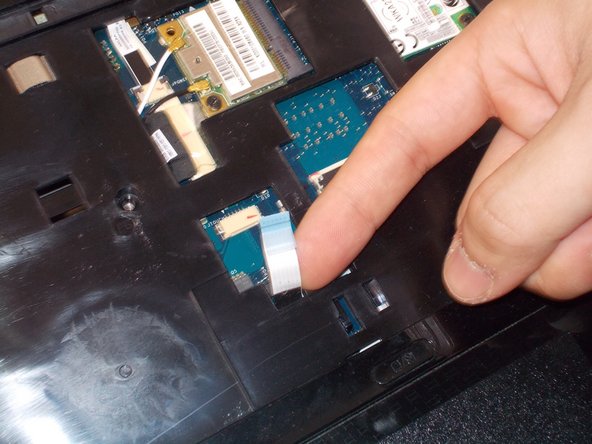

    • Locate the track-pad connector ribbon.
    • Pull ribbon away from its connector.

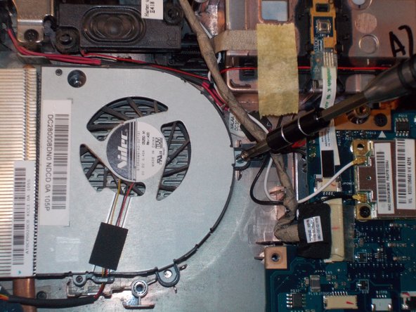

  13. Toshiba Satellite L675D-S7015 Cooling Fan Replacement: crwdns2935265:013crwdnd2935265:01crwdnd2935265:02crwdne2935265:0 Toshiba Satellite L675D-S7015 Cooling Fan Replacement: crwdns2935265:013crwdnd2935265:02crwdnd2935265:02crwdne2935265:0
    • Locate and remove the two 5mm screws using the screwdriver.

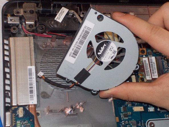

  14. Toshiba Satellite L675D-S7015 Cooling Fan Replacement: crwdns2935265:014crwdnd2935265:01crwdnd2935265:02crwdne2935265:0 Toshiba Satellite L675D-S7015 Cooling Fan Replacement: crwdns2935265:014crwdnd2935265:02crwdnd2935265:02crwdne2935265:0
    • Use a spudger to disconnect the fan wire from its connector.
    • Remove the fan from the device.
    • Be careful not to damage the fan connector pins. A broken pin may require you to completely replace the fan.
