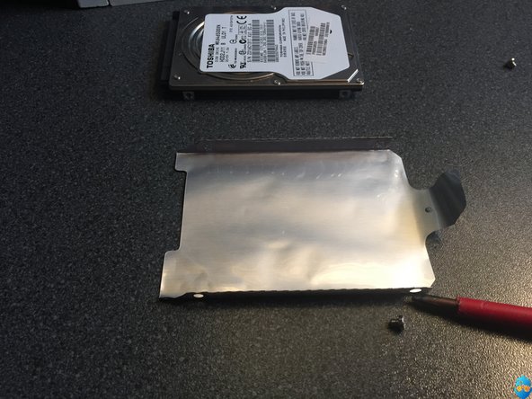

  6. Toshiba Satellite L670 HDD replacement, Unscrew the HDD cover: crwdns2935265:06crwdnd2935265:01crwdnd2935265:02crwdne2935265:0 Toshiba Satellite L670 HDD replacement, Unscrew the HDD cover: crwdns2935265:06crwdnd2935265:02crwdnd2935265:02crwdne2935265:0
    • Remove the 4 screws from the hard drive.
  7. Toshiba Satellite L670 HDD replacement, Insert your new SSD in the case: crwdns2935265:07crwdnd2935265:01crwdnd2935265:03crwdne2935265:0 Toshiba Satellite L670 HDD replacement, Insert your new SSD in the case: crwdns2935265:07crwdnd2935265:02crwdnd2935265:03crwdne2935265:0 Toshiba Satellite L670 HDD replacement, Insert your new SSD in the case: crwdns2935265:07crwdnd2935265:03crwdnd2935265:03crwdne2935265:0
    • Take your new SSD hard drive.
    • Place the SSD in the silver case.
    • Place back the 4 screws you just removed.
