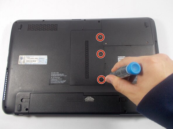

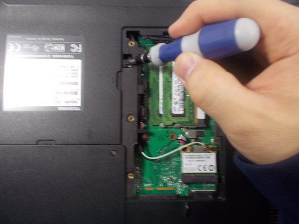

    • Unscrew the panel located over the RAM as shown
    • Rotate the computer so the battery is now located on the top of the device. Now unscrew the single screw located at the top left of the RAM's housing as shown

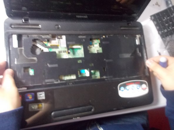

    • Now turn the device over so you can see the keyboard. Find the plastic bar located at the top of the keyboard.
    • Pry this plastic cover off with the use of the plastic opening tools.
    • Now unscrew the screws that are located under the plastic cover previously removed. After these are gone, remove the keyboard.
  8. Toshiba Satellite L655D-S5095 Touchpad Button Replacement: crwdns2935265:08crwdnd2935265:01crwdnd2935265:03crwdne2935265:0 Toshiba Satellite L655D-S5095 Touchpad Button Replacement: crwdns2935265:08crwdnd2935265:02crwdnd2935265:03crwdne2935265:0 Toshiba Satellite L655D-S5095 Touchpad Button Replacement: crwdns2935265:08crwdnd2935265:03crwdnd2935265:03crwdne2935265:0

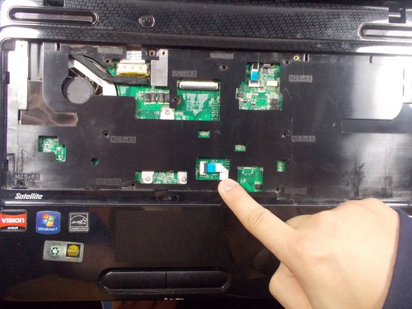

    • Remove the screws located around the area the keyboard had previously covered, as shown in the red circles.
    • Before removing this cover, locate the connection indicated in the photo and disconnect it.
    • Remove the cover.
    • remove all screws on bottom marked F65

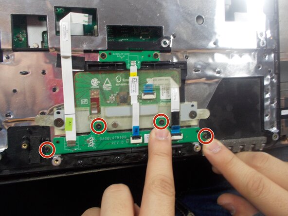

    • Turn the cover over and remove the back panel.
    • Locate the button found at the lower end of the cover. Once found, remove the four screws keeping it in place.

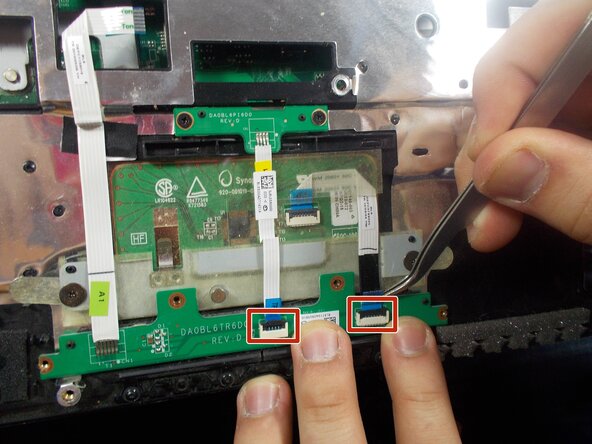

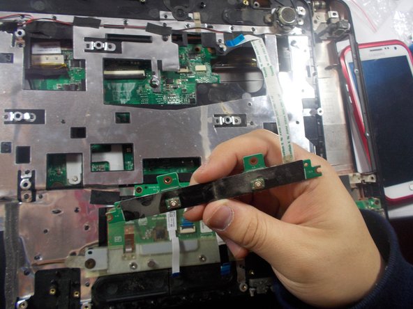

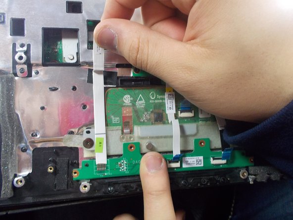

    • Remove the two buses from the button by the blue tab as shown in the pictures.
    • Remove the last bus from the motherboard by pulling the blue tab.
    • Remove the disfunctional button from the device.
