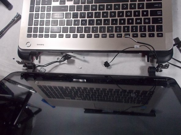

    • Unscrew the four 6mm screws from each of the laptop hinges using a Philips head #00 screwdriver.
  6. Toshiba Satellite L55t-B5271 Screen Replacement: crwdns2935265:06crwdnd2935265:01crwdnd2935265:03crwdne2935265:0 Toshiba Satellite L55t-B5271 Screen Replacement: crwdns2935265:06crwdnd2935265:02crwdnd2935265:03crwdne2935265:0 Toshiba Satellite L55t-B5271 Screen Replacement: crwdns2935265:06crwdnd2935265:03crwdnd2935265:03crwdne2935265:0
    • Disconnect connect the ribbon marked in red.
    • Disconnect all ribbons and cables marked in orange.
  7. Toshiba Satellite L55t-B5271 Screen Replacement: crwdns2935265:07crwdnd2935265:01crwdnd2935265:01crwdne2935265:0
    • Flip your laptop back to the front.
    • Lift up the screen cover.

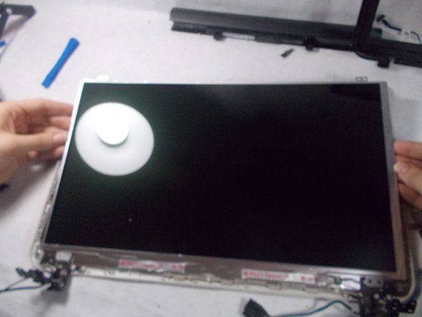

  8. Toshiba Satellite L55t-B5271 Screen Replacement: crwdns2935265:08crwdnd2935265:01crwdnd2935265:02crwdne2935265:0 Toshiba Satellite L55t-B5271 Screen Replacement: crwdns2935265:08crwdnd2935265:02crwdnd2935265:02crwdne2935265:0
    • Gently pull the screen to disconnect the monitor from the hinges.
  9. Toshiba Satellite L55t-B5271 Screen Replacement: crwdns2935265:09crwdnd2935265:01crwdnd2935265:03crwdne2935265:0 Toshiba Satellite L55t-B5271 Screen Replacement: crwdns2935265:09crwdnd2935265:02crwdnd2935265:03crwdne2935265:0 Toshiba Satellite L55t-B5271 Screen Replacement: crwdns2935265:09crwdnd2935265:03crwdnd2935265:03crwdne2935265:0
    • Use the plastic opening tool to pry the plastic covering off of the monitor.
    • Be careful not to break the glass, as this can cause injury.

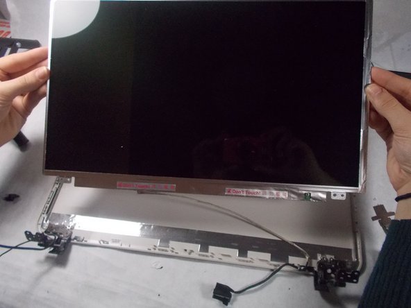

  10. Toshiba Satellite L55t-B5271 Screen Replacement: crwdns2935265:010crwdnd2935265:01crwdnd2935265:03crwdne2935265:0 Toshiba Satellite L55t-B5271 Screen Replacement: crwdns2935265:010crwdnd2935265:02crwdnd2935265:03crwdne2935265:0 Toshiba Satellite L55t-B5271 Screen Replacement: crwdns2935265:010crwdnd2935265:03crwdnd2935265:03crwdne2935265:0
    • Remove the four 3mm Phillips head screws with a Phillips #00 screwdriver.
    • Gently remove the screen from the device.
