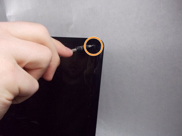

    • Remove screw coverings from casing.
    • Remove the M2 5x6 mm screws that under the screw covers that you removed using a Phillips #0 screwdriver.
    • Keep screws and covers together in a pile for easier reassembly.

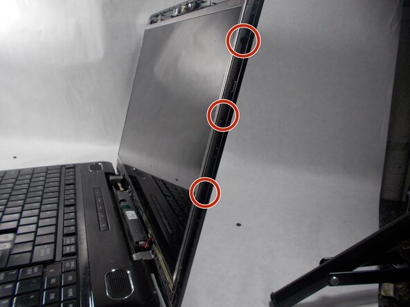

  4. Toshiba Satellite L505D-GS6000 Screen Replacement: crwdns2935265:04crwdnd2935265:01crwdnd2935265:03crwdne2935265:0 Toshiba Satellite L505D-GS6000 Screen Replacement: crwdns2935265:04crwdnd2935265:02crwdnd2935265:03crwdne2935265:0 Toshiba Satellite L505D-GS6000 Screen Replacement: crwdns2935265:04crwdnd2935265:03crwdnd2935265:03crwdne2935265:0
    • Carefully pry the screen covering out of place to remove it and set it to the side.
    • It may be helpful to use a plastic opening tool to assist in removal of the screen cover.

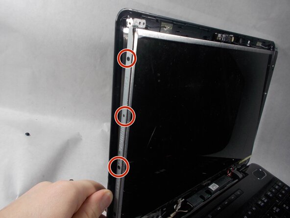

  5. Toshiba Satellite L505D-GS6000 Screen Replacement: crwdns2935265:05crwdnd2935265:01crwdnd2935265:03crwdne2935265:0 Toshiba Satellite L505D-GS6000 Screen Replacement: crwdns2935265:05crwdnd2935265:02crwdnd2935265:03crwdne2935265:0 Toshiba Satellite L505D-GS6000 Screen Replacement: crwdns2935265:05crwdnd2935265:03crwdnd2935265:03crwdne2935265:0
    • Remove the three M2 5x6 mm screws on each side holding the screen in place, using the Phillips #0 screwdriver.
    • Gently rest the screen on the keyboard, making sure not to damage any of the wires attached to it.

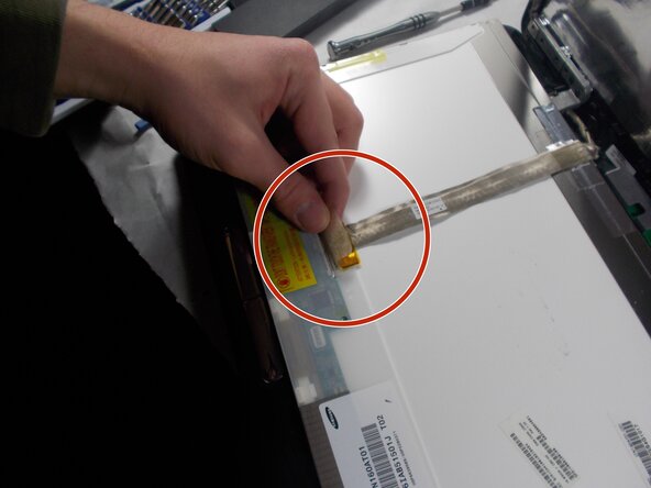

  6. Toshiba Satellite L505D-GS6000 Screen Replacement: crwdns2935265:06crwdnd2935265:01crwdnd2935265:02crwdne2935265:0 Toshiba Satellite L505D-GS6000 Screen Replacement: crwdns2935265:06crwdnd2935265:02crwdnd2935265:02crwdne2935265:0
    • Disconnect wire at the base of the screen from the laptop.
    • Be very gentle as to not damage any electrical components of the computer.

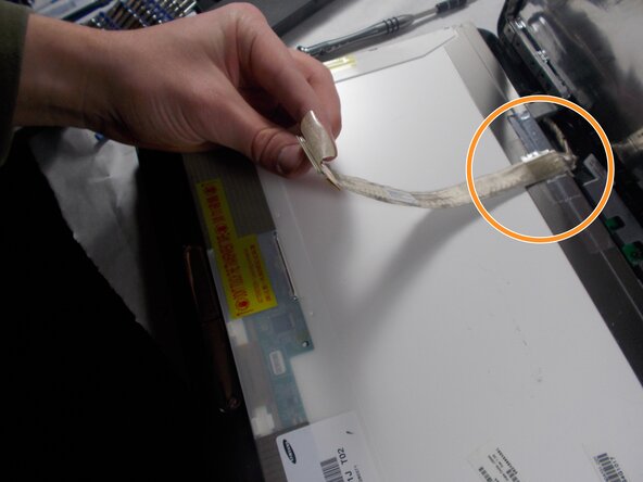

  7. Toshiba Satellite L505D-GS6000 Screen Replacement: crwdns2935265:07crwdnd2935265:01crwdnd2935265:03crwdne2935265:0 Toshiba Satellite L505D-GS6000 Screen Replacement: crwdns2935265:07crwdnd2935265:02crwdnd2935265:03crwdne2935265:0 Toshiba Satellite L505D-GS6000 Screen Replacement: crwdns2935265:07crwdnd2935265:03crwdnd2935265:03crwdne2935265:0
    • Peel back adhesive from the second connection to the screen and unplug the connection.
    • Remove secondary adhesive from the screen connection at the base of the screen.
    • Be cautious when removing the tape, as it will be reused for the replacement screen, so be sure not to rip it.
    • The screen is now free to be removed from the device.
