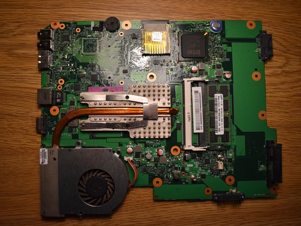

  14. Toshiba Satellite L505 Laptop Fan Replacement, Motherboard: crwdns2935265:014crwdnd2935265:01crwdnd2935265:02crwdne2935265:0 Toshiba Satellite L505 Laptop Fan Replacement, Motherboard: crwdns2935265:014crwdnd2935265:02crwdnd2935265:02crwdne2935265:0
    • Once the Motherboard is exposed, unscrew the screws circled in red.
    • Afterwards, gently unplug all the wires connected to the motherboard.
  15. Toshiba Satellite L505 Laptop Fan Replacement: crwdns2935265:015crwdnd2935265:01crwdnd2935265:02crwdne2935265:0 Toshiba Satellite L505 Laptop Fan Replacement: crwdns2935265:015crwdnd2935265:02crwdnd2935265:02crwdne2935265:0
    • Once ready to remove the motherboard, carefully pry it away from the bottom first, as to not risk damage to the chassis, since the volume wheel sticks out of the motherboard to the exterior.
  16. Toshiba Satellite L505 Laptop Fan Replacement, Fan: crwdns2935265:016crwdnd2935265:01crwdnd2935265:02crwdne2935265:0 Toshiba Satellite L505 Laptop Fan Replacement, Fan: crwdns2935265:016crwdnd2935265:02crwdnd2935265:02crwdne2935265:0
    • Separate the motherboard from the device and flip it over.
