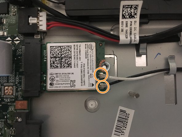

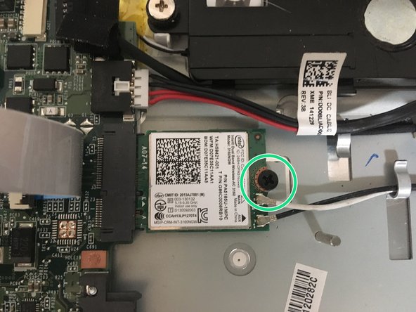

  10. Toshiba Satellite L50-B Keyboard / Palm Rest Replacement, Disconnect the WiFi Card: crwdns2935265:010crwdnd2935265:01crwdnd2935265:03crwdne2935265:0 Toshiba Satellite L50-B Keyboard / Palm Rest Replacement, Disconnect the WiFi Card: crwdns2935265:010crwdnd2935265:02crwdnd2935265:03crwdne2935265:0 Toshiba Satellite L50-B Keyboard / Palm Rest Replacement, Disconnect the WiFi Card: crwdns2935265:010crwdnd2935265:03crwdnd2935265:03crwdne2935265:0
    • Remove the screw using a PH1 Phillips screwdriver.
    • Disconnect the 2 antenna cables.
    • Pay attention to the colors when reconnecting the two cables during reassembly.
  11. Toshiba Satellite L50-B Keyboard / Palm Rest Replacement, Remove the WiFi Card: crwdns2935265:011crwdnd2935265:01crwdnd2935265:02crwdne2935265:0 Toshiba Satellite L50-B Keyboard / Palm Rest Replacement, Remove the WiFi Card: crwdns2935265:011crwdnd2935265:02crwdnd2935265:02crwdne2935265:0
    • Pull the card straight out away from the motherboard to remove it.
    • Take note of the cable routing for reassembly.

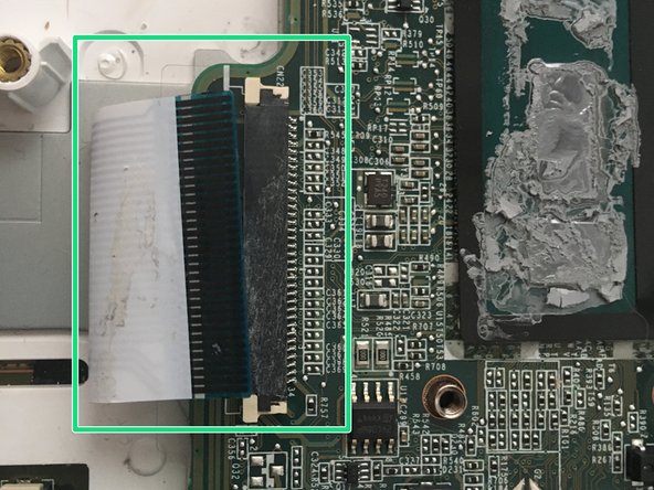

  13. Toshiba Satellite L50-B Keyboard / Palm Rest Replacement, Disconnect the Trackpad: crwdns2935265:013crwdnd2935265:01crwdnd2935265:01crwdne2935265:0
    • Unplug the ZIF connector on the trackpad securing the ribbon cable to the motherboard.
