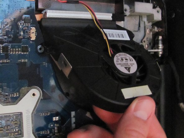

  17. Toshiba Satellite L455D-S5976 CPU Replacement, CPU: crwdns2935265:017crwdnd2935265:01crwdnd2935265:01crwdne2935265:0
    • Remove the two Phillips #1 3mm screws from the fan using a Phillips #1 screwdriver.
  18. Toshiba Satellite L455D-S5976 CPU Replacement: crwdns2935265:018crwdnd2935265:01crwdnd2935265:01crwdne2935265:0
    • Remove the two cables from the fan.
  19. Toshiba Satellite L455D-S5976 CPU Replacement: crwdns2935265:019crwdnd2935265:01crwdnd2935265:02crwdne2935265:0 Toshiba Satellite L455D-S5976 CPU Replacement: crwdns2935265:019crwdnd2935265:02crwdnd2935265:02crwdne2935265:0
    • LIft up on the fan and remove it from the computer.

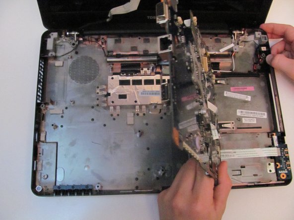

    • Remove the six 6mm screws from the motherboard with a #1 phillips screwdriver.
  21. Toshiba Satellite L455D-S5976 CPU Replacement: crwdns2935265:021crwdnd2935265:01crwdnd2935265:01crwdne2935265:0
    • Remove the lone 10mm screw from the motherboard with a phillips #1 screwdriver.
  22. Toshiba Satellite L455D-S5976 CPU Replacement: crwdns2935265:022crwdnd2935265:01crwdnd2935265:02crwdne2935265:0 Toshiba Satellite L455D-S5976 CPU Replacement: crwdns2935265:022crwdnd2935265:02crwdnd2935265:02crwdne2935265:0
    • Remove the motherboard with your hands by carefully lifting up and pulling out.

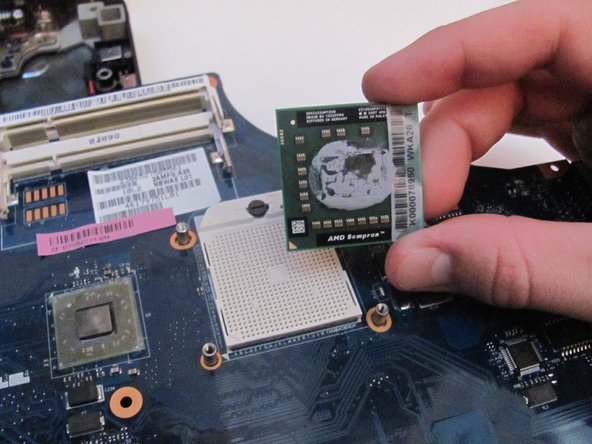

    • Remove the four Phillips #1 6mm single coil pickup screws from the cooling unit and remove the cooling unit.
  24. Toshiba Satellite L455D-S5976 CPU Replacement: crwdns2935265:024crwdnd2935265:01crwdnd2935265:02crwdne2935265:0 Toshiba Satellite L455D-S5976 CPU Replacement: crwdns2935265:024crwdnd2935265:02crwdnd2935265:02crwdne2935265:0
    • Using a flathead screwdriver, undo the lock on the CPU with a half turn in the counterclockwise direction.
    • Remove the CPU by lifting up on the chip.
