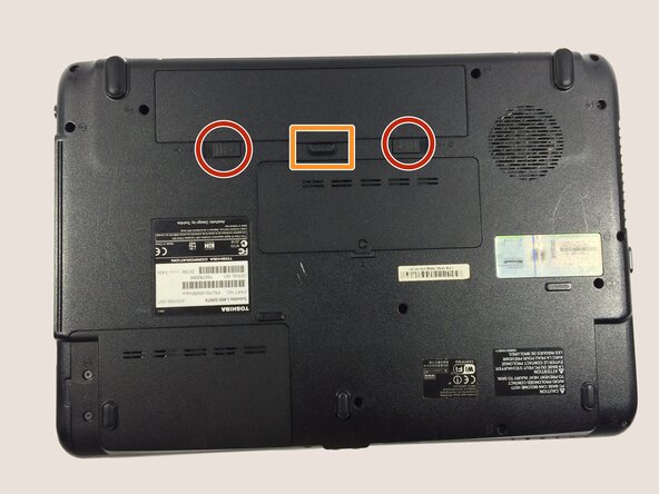

    • Flip the Laptop into an upside-down position.
    • Push the latches (indicated in red) outwards.
    • Lift the battery by its notch (indicated in orange) in order to remove.

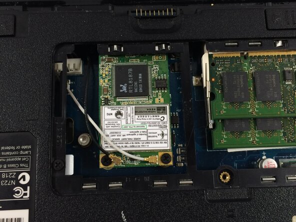

  2. Toshiba Satellite L455-S5975 WiFi Card Replacement: crwdns2935265:02crwdnd2935265:01crwdnd2935265:02crwdne2935265:0 Toshiba Satellite L455-S5975 WiFi Card Replacement: crwdns2935265:02crwdnd2935265:02crwdnd2935265:02crwdne2935265:0
    • Using a Phillips #00 screwdriver, unscrew the single 7mm screw (indicated in red).
    • Remove the plastic covering, where the screw was removed, using a provided plastic opening tool.

    • Locate the Wifi Card on the left-hand side of the compartment you previously revealed in step 2.
    • Locate the black and white wires. Lift the plastic lever gently to release each wire individually. (A light snapping sound will occur)

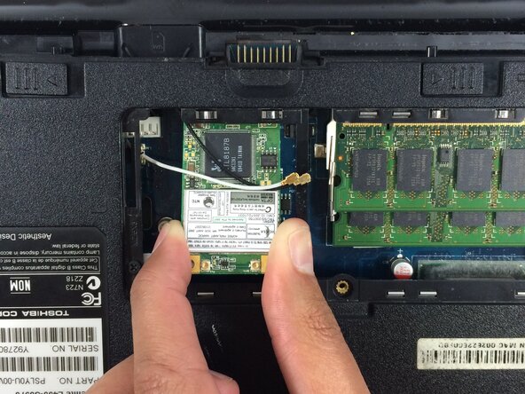

  4. Toshiba Satellite L455-S5975 WiFi Card Replacement: crwdns2935265:04crwdnd2935265:01crwdnd2935265:01crwdne2935265:0
    • Locate the two 6 mm screws at the bottom of the wifi card (indicated in red). Unscrew both, using Phillips #00 screwdriver. Save and store the screws in a safe location.
  5. Toshiba Satellite L455-S5975 WiFi Card Replacement: crwdns2935265:05crwdnd2935265:01crwdnd2935265:02crwdne2935265:0 Toshiba Satellite L455-S5975 WiFi Card Replacement: crwdns2935265:05crwdnd2935265:02crwdnd2935265:02crwdne2935265:0
    • Gently remove the wifi card from the laptop as demonstrated in the red circle.
Note: When installing new WiFi card be sure to connect the black wire to the right where there is a small letter “B” imprinted and place white on the opposite side.
