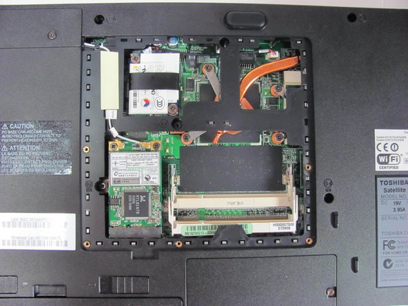

  4. Toshiba Satellite L45-S7423 RAM Replacement, Bottom Access Panel: crwdns2935265:04crwdnd2935265:01crwdnd2935265:03crwdne2935265:0 Toshiba Satellite L45-S7423 RAM Replacement, Bottom Access Panel: crwdns2935265:04crwdnd2935265:02crwdnd2935265:03crwdne2935265:0 Toshiba Satellite L45-S7423 RAM Replacement, Bottom Access Panel: crwdns2935265:04crwdnd2935265:03crwdnd2935265:03crwdne2935265:0
    • Remove the 5 Phillips screws holding the panel in place.
    • These screws are permanently fastened to the panel; they are designed to be removed only partially to avoid loss.
  5. Toshiba Satellite L45-S7423 RAM Replacement: crwdns2935265:05crwdnd2935265:01crwdnd2935265:03crwdne2935265:0 Toshiba Satellite L45-S7423 RAM Replacement: crwdns2935265:05crwdnd2935265:02crwdnd2935265:03crwdne2935265:0 Toshiba Satellite L45-S7423 RAM Replacement: crwdns2935265:05crwdnd2935265:03crwdnd2935265:03crwdne2935265:0
    • Use a finger to remove the panel by lifting up on the provided removal tab.

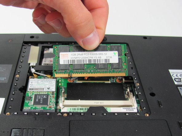

  6. Toshiba Satellite L45-S7423 RAM Replacement, RAM: crwdns2935265:06crwdnd2935265:01crwdnd2935265:03crwdne2935265:0 Toshiba Satellite L45-S7423 RAM Replacement, RAM: crwdns2935265:06crwdnd2935265:02crwdnd2935265:03crwdne2935265:0 Toshiba Satellite L45-S7423 RAM Replacement, RAM: crwdns2935265:06crwdnd2935265:03crwdnd2935265:03crwdne2935265:0
    • Pull apart the two tabs holding the RAM in place.
  7. Toshiba Satellite L45-S7423 RAM Replacement: crwdns2935265:07crwdnd2935265:01crwdnd2935265:01crwdne2935265:0
    • Upon release, RAM will automatically pop up.
  8. Toshiba Satellite L45-S7423 RAM Replacement: crwdns2935265:08crwdnd2935265:01crwdnd2935265:03crwdne2935265:0 Toshiba Satellite L45-S7423 RAM Replacement: crwdns2935265:08crwdnd2935265:02crwdnd2935265:03crwdne2935265:0 Toshiba Satellite L45-S7423 RAM Replacement: crwdns2935265:08crwdnd2935265:03crwdnd2935265:03crwdne2935265:0
    • Gently pull on RAM to remove.
