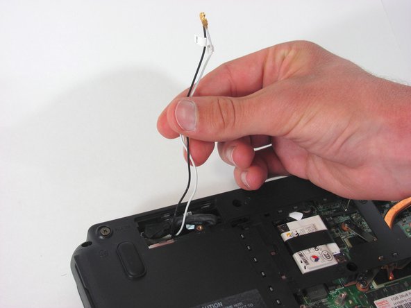

    • With the aid of a plastic removal, disconnect the two wires attached to the wireless card.
  8. Toshiba Satellite L45-S7423 LCD Display Replacement: crwdns2935265:08crwdnd2935265:01crwdnd2935265:01crwdne2935265:0

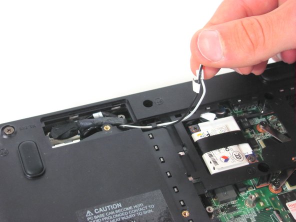

    • Remove the yellow tape holding the black and the white wires in place.
  9. Toshiba Satellite L45-S7423 LCD Display Replacement: crwdns2935265:09crwdnd2935265:01crwdnd2935265:03crwdne2935265:0 Toshiba Satellite L45-S7423 LCD Display Replacement: crwdns2935265:09crwdnd2935265:02crwdnd2935265:03crwdne2935265:0 Toshiba Satellite L45-S7423 LCD Display Replacement: crwdns2935265:09crwdnd2935265:03crwdnd2935265:03crwdne2935265:0
    • Unwind the wires from the plastic tabs holding the wires in place.
