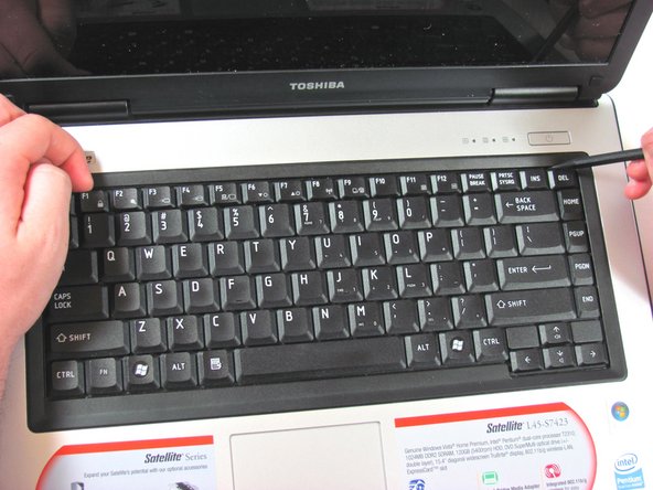

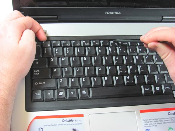

  8. Toshiba Satellite L45-S7423 Keyboard Replacement: crwdns2935265:08crwdnd2935265:01crwdnd2935265:03crwdne2935265:0 Toshiba Satellite L45-S7423 Keyboard Replacement: crwdns2935265:08crwdnd2935265:02crwdnd2935265:03crwdne2935265:0 Toshiba Satellite L45-S7423 Keyboard Replacement: crwdns2935265:08crwdnd2935265:03crwdnd2935265:03crwdne2935265:0
    • While you press down the ESC key, push the tab with the spudger to release that side of the keyboard.
    • Use a finger to prevent the keyboard from locking back in place.
    • Repeat the previous step for the tabs under the F8 and DEL keys.
