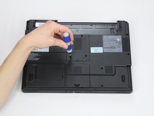

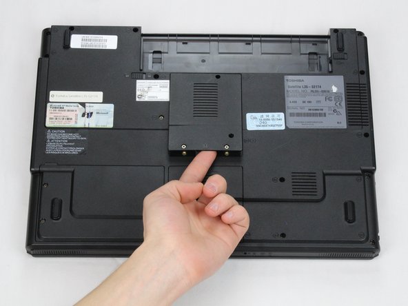

  5. Toshiba Satellite L35-S2174 RAM Replacement, RAM: crwdns2935265:05crwdnd2935265:01crwdnd2935265:03crwdne2935265:0 Toshiba Satellite L35-S2174 RAM Replacement, RAM: crwdns2935265:05crwdnd2935265:02crwdnd2935265:03crwdne2935265:0 Toshiba Satellite L35-S2174 RAM Replacement, RAM: crwdns2935265:05crwdnd2935265:03crwdnd2935265:03crwdne2935265:0
    • Unscrew the two circled screws with a J1 screwdriver. The screws will remain attached to the panel.
    • Lift the panel and remove it from the laptop.
