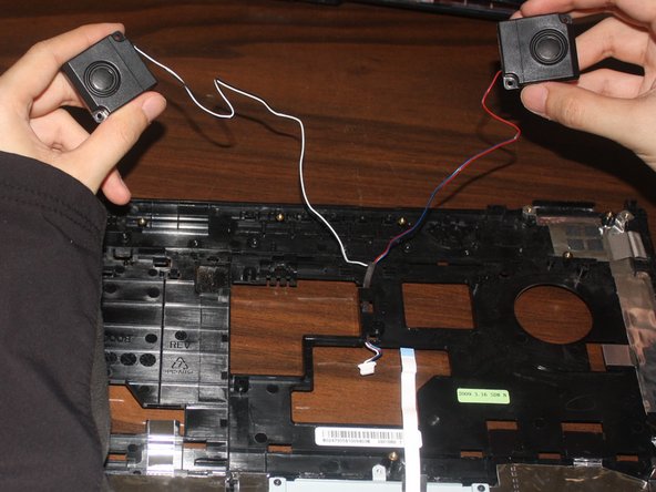

  11. Toshiba Satellite L305D-S5950 Speaker Replacement, Speaker: crwdns2935265:011crwdnd2935265:01crwdnd2935265:02crwdne2935265:0 Toshiba Satellite L305D-S5950 Speaker Replacement, Speaker: crwdns2935265:011crwdnd2935265:02crwdnd2935265:02crwdne2935265:0
    • Use a phillips head #00 screwdriver to remove the two 5.25mm screws.
  12. Toshiba Satellite L305D-S5950 Speaker Replacement: crwdns2935265:012crwdnd2935265:01crwdnd2935265:02crwdne2935265:0 Toshiba Satellite L305D-S5950 Speaker Replacement: crwdns2935265:012crwdnd2935265:02crwdnd2935265:02crwdne2935265:0
    • Turn the keyboard housing over and disconnect the speaker power wire from the keyboard housing.
    • Remove both speakers.
