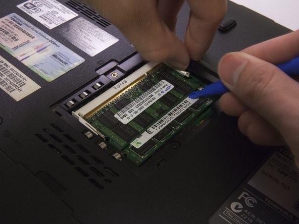

    • Remove the panel that houses the RAM chips by removing the screw that secures it into its spot.
  3. Toshiba Satellite L305D-S5900 RAM Replacement: crwdns2935265:03crwdnd2935265:01crwdnd2935265:03crwdne2935265:0 Toshiba Satellite L305D-S5900 RAM Replacement: crwdns2935265:03crwdnd2935265:02crwdnd2935265:03crwdne2935265:0 Toshiba Satellite L305D-S5900 RAM Replacement: crwdns2935265:03crwdnd2935265:03crwdnd2935265:03crwdne2935265:0

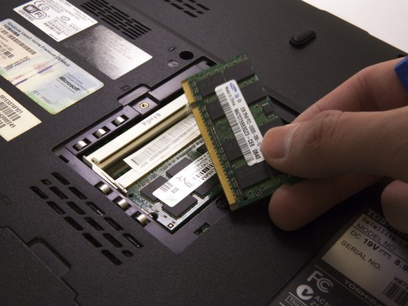

    • There are two metal holdings boxed in red is located at each side of the RAM chip (left and right).
    • Use a plastic opening tool or your fingers to carefully pull or push up from the underside of the RAM chip until it naturally sits in the socket at an angle.
    • If using too much force, push aside the metal holdings that holds on to the RAM chip on both side then attempt lifting it up
    • There are two RAM chips that can be removes. To remove the second RAM chips follow the same instructed as above.
