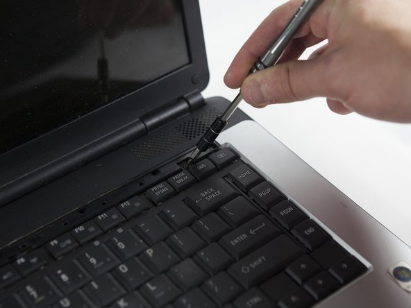

    • Power off your laptop before beginning disassembly.
    • The plastic strip boxed in red is located above the keyboard of the computer.
  2. Toshiba Satellite L305D-S5900 Keyboard Replacement: crwdns2935265:02crwdnd2935265:01crwdnd2935265:03crwdne2935265:0 Toshiba Satellite L305D-S5900 Keyboard Replacement: crwdns2935265:02crwdnd2935265:02crwdnd2935265:03crwdne2935265:0 Toshiba Satellite L305D-S5900 Keyboard Replacement: crwdns2935265:02crwdnd2935265:03crwdnd2935265:03crwdne2935265:0
    • There are three points of contact boxed in red needed to release located at the far left, the far right and the middle of the plastic strip.
    • Remove the plastic strip from one far end progressively towards the other end using a metal spludger.
  3. Toshiba Satellite L305D-S5900 Keyboard Replacement: crwdns2935265:03crwdnd2935265:01crwdnd2935265:02crwdne2935265:0 Toshiba Satellite L305D-S5900 Keyboard Replacement: crwdns2935265:03crwdnd2935265:02crwdnd2935265:02crwdne2935265:0
    • Remove the two 5.3 mm Phillips #1 screws that are beneath the strip.
    • The screws located at the far left and far right when the plastic strip is removed.
  4. Toshiba Satellite L305D-S5900 Keyboard Replacement: crwdns2935265:04crwdnd2935265:01crwdnd2935265:02crwdne2935265:0 Toshiba Satellite L305D-S5900 Keyboard Replacement: crwdns2935265:04crwdnd2935265:02crwdnd2935265:02crwdne2935265:0
    • Use the metal spludger to push the keyboard in the direction of the track pad and then lift the keyboard up.
    • Be careful not to pull too fast as there is still another cable attaching the keyboard.
  5. Toshiba Satellite L305D-S5900 Keyboard Replacement: crwdns2935265:05crwdnd2935265:01crwdnd2935265:03crwdne2935265:0 Toshiba Satellite L305D-S5900 Keyboard Replacement: crwdns2935265:05crwdnd2935265:02crwdnd2935265:03crwdne2935265:0 Toshiba Satellite L305D-S5900 Keyboard Replacement: crwdns2935265:05crwdnd2935265:03crwdnd2935265:03crwdne2935265:0
    • There are two tab boxed in red is located at each side of the ZIF (zero insertion force) connector.
    • Use a metal spludger to push the tab upward in order to release the cable ribbon.
    • Carefully pull out the ribbon cable from the ZIF (zero insertion force) connector.
