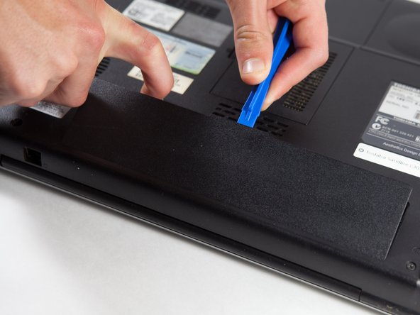

    • Power off your laptop before beginning dissassembly.
    • The left-hand switch and right-hand switch boxed in red located at the bottom on the underside of the computer.
  2. Toshiba Satellite L305D-S5900 Battery Replacement: crwdns2935265:02crwdnd2935265:01crwdnd2935265:01crwdne2935265:0
    • Set the right-hand switch near the battery into the unlock position (move switch from left to right).
  3. Toshiba Satellite L305D-S5900 Battery Replacement: crwdns2935265:03crwdnd2935265:01crwdnd2935265:01crwdne2935265:0
    • Set and hold the left hand switch near the battery into its unlock position (move switch from right to left).
  4. Toshiba Satellite L305D-S5900 Battery Replacement: crwdns2935265:04crwdnd2935265:01crwdnd2935265:02crwdne2935265:0 Toshiba Satellite L305D-S5900 Battery Replacement: crwdns2935265:04crwdnd2935265:02crwdnd2935265:02crwdne2935265:0
    • While both switches are in their unlocked positions, use a plastic opening tool or your fingers to lift out the battery at the indent between the switches.
    • The right hand switch regardless of initial position will stay or return to the unlock position when a battery is placed back in the slot. To avoid any mishaps, be sure to set the switch back into the lock position while any battery is plugged in.
