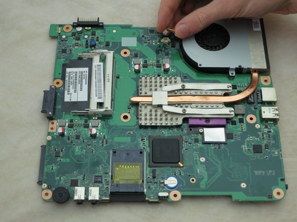

  33. Toshiba Satellite L305-S5946 Cooling Fan Replacement, Cooling Fan: crwdns2935265:033crwdnd2935265:01crwdnd2935265:01crwdne2935265:0
    • Flip the motherboard over. Remove the two 3-mm screws from the fan using a Phillips #1 screwdriver.
  34. Toshiba Satellite L305-S5946 Cooling Fan Replacement: crwdns2935265:034crwdnd2935265:01crwdnd2935265:02crwdne2935265:0 Toshiba Satellite L305-S5946 Cooling Fan Replacement: crwdns2935265:034crwdnd2935265:02crwdnd2935265:02crwdne2935265:0
    • Remove the housing equipped with red, blue, and yellow wires using your fingers.
  35. Toshiba Satellite L305-S5946 Cooling Fan Replacement: crwdns2935265:035crwdnd2935265:01crwdnd2935265:01crwdne2935265:0
    • Remove the fan from the heatsink using your fingers.
