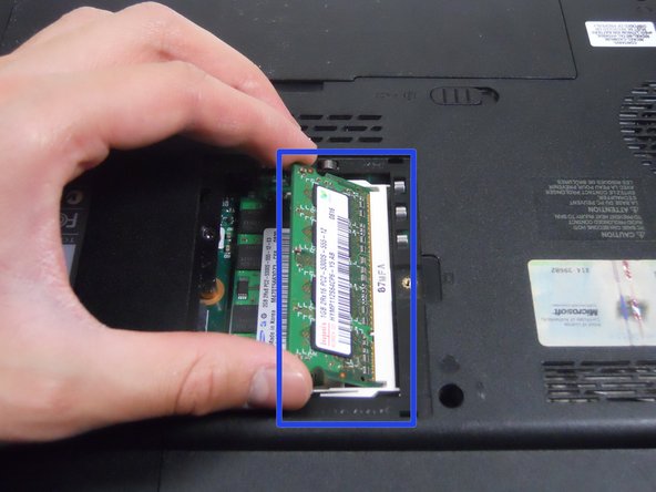

  3. Toshiba Satellite L305-S5875 RAM Replacement, RAM: crwdns2935265:03crwdnd2935265:01crwdnd2935265:03crwdne2935265:0 Toshiba Satellite L305-S5875 RAM Replacement, RAM: crwdns2935265:03crwdnd2935265:02crwdnd2935265:03crwdne2935265:0 Toshiba Satellite L305-S5875 RAM Replacement, RAM: crwdns2935265:03crwdnd2935265:03crwdnd2935265:03crwdne2935265:0
    • Locate the RAM Module compartment on the bottom side of the laptop.
    • Carefully remove the 4.6mm 0 Phillips head screw and put it in a safe place.
    • Locate the notch on the screw side of the lid and lift to remove it.
  4. Toshiba Satellite L305-S5875 RAM Replacement: crwdns2935265:04crwdnd2935265:01crwdnd2935265:03crwdne2935265:0 Toshiba Satellite L305-S5875 RAM Replacement: crwdns2935265:04crwdnd2935265:02crwdnd2935265:03crwdne2935265:0 Toshiba Satellite L305-S5875 RAM Replacement: crwdns2935265:04crwdnd2935265:03crwdnd2935265:03crwdne2935265:0
    • Push the metal tabs on the sides of the RAM outward and the RAM will pop up.
    • Gently pull the RAM out.
    • Replace the RAM by sliding the new one into the angled socket similarly to how you removed the old RAM.
    • Gently apply pressure until the metal tabs on the sides click into place.
