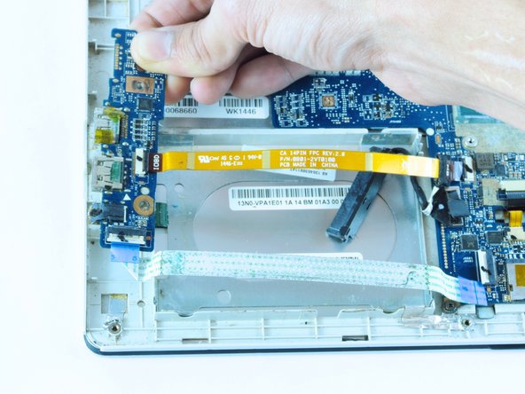

  7. Toshiba Satellite E45t-B4300 USB HDMI Audio Circuit Board Replacement, USB HDMI Audio Circuit Board: crwdns2935265:07crwdnd2935265:01crwdnd2935265:03crwdne2935265:0 Toshiba Satellite E45t-B4300 USB HDMI Audio Circuit Board Replacement, USB HDMI Audio Circuit Board: crwdns2935265:07crwdnd2935265:02crwdnd2935265:03crwdne2935265:0 Toshiba Satellite E45t-B4300 USB HDMI Audio Circuit Board Replacement, USB HDMI Audio Circuit Board: crwdns2935265:07crwdnd2935265:03crwdnd2935265:03crwdne2935265:0
    • Use the point end of the spudger to lift the clips that attach the two ribbons to the motherboard.
    • Pull out the ribbons from the motherboard.
  8. Toshiba Satellite E45t-B4300 USB HDMI Audio Circuit Board Replacement: crwdns2935265:08crwdnd2935265:01crwdnd2935265:02crwdne2935265:0 Toshiba Satellite E45t-B4300 USB HDMI Audio Circuit Board Replacement: crwdns2935265:08crwdnd2935265:02crwdnd2935265:02crwdne2935265:0
    • Unscrew the 2mm screw with a Phillips #0 screwdriver.
    • Remove the circuit board.
