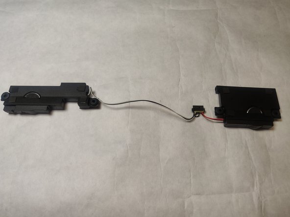

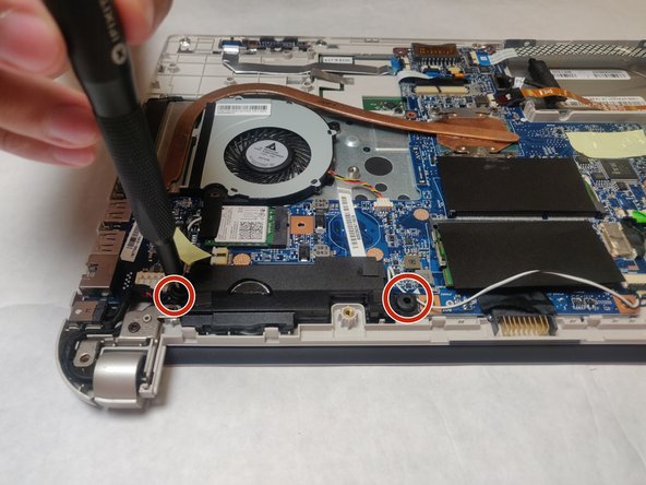

    • Remove speaker by unscrewing the 4 screws at the side of the speaker with the Phillips #1 screwdriver.
  5. Toshiba Satellite E45t-B4204 Keyboard  Replacement: crwdns2935265:05crwdnd2935265:01crwdnd2935265:02crwdne2935265:0 Toshiba Satellite E45t-B4204 Keyboard  Replacement: crwdns2935265:05crwdnd2935265:02crwdnd2935265:02crwdne2935265:0
    • Unplug speaker wires from the motherboard using a spudger or plastic opening tool.
    • Using a metal spudger as shown in the photo could potentially damage your device.
    • Remove speakers.

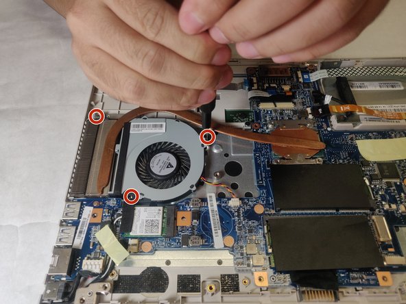

    • Unscrew 6 screws from the chassis with the Phillips #1 screwdriver.
  7. Toshiba Satellite E45t-B4204 Keyboard  Replacement: crwdns2935265:07crwdnd2935265:01crwdnd2935265:02crwdne2935265:0 Toshiba Satellite E45t-B4204 Keyboard  Replacement: crwdns2935265:07crwdnd2935265:02crwdnd2935265:02crwdne2935265:0

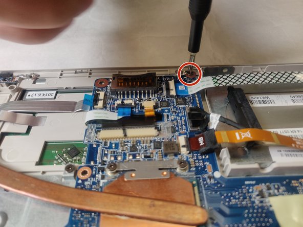

    • Unscrew 8 screws from the motherboard using the Phillips #1 screwdriver.
  8. Toshiba Satellite E45t-B4204 Keyboard  Replacement: crwdns2935265:08crwdnd2935265:01crwdnd2935265:02crwdne2935265:0 Toshiba Satellite E45t-B4204 Keyboard  Replacement: crwdns2935265:08crwdnd2935265:02crwdnd2935265:02crwdne2935265:0

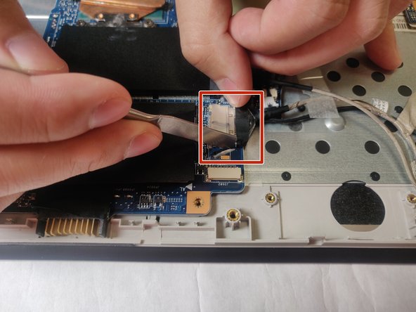

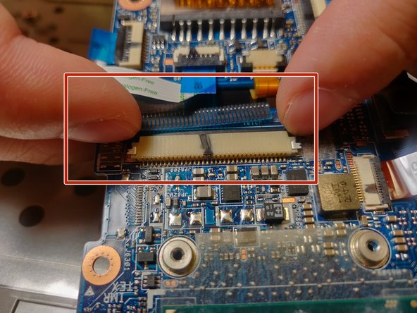

    • Unplug wire from the motherboard.
  9. Toshiba Satellite E45t-B4204 Keyboard  Replacement: crwdns2935265:09crwdnd2935265:01crwdnd2935265:03crwdne2935265:0 Toshiba Satellite E45t-B4204 Keyboard  Replacement: crwdns2935265:09crwdnd2935265:02crwdnd2935265:03crwdne2935265:0 Toshiba Satellite E45t-B4204 Keyboard  Replacement: crwdns2935265:09crwdnd2935265:03crwdnd2935265:03crwdne2935265:0

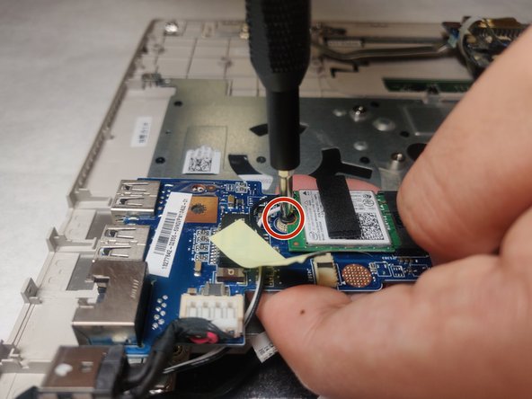

    • Unscrew screws from the motherboard using the Phillips #1 screwdriver.
  10. Toshiba Satellite E45t-B4204 Keyboard  Replacement: crwdns2935265:010crwdnd2935265:01crwdnd2935265:02crwdne2935265:0 Toshiba Satellite E45t-B4204 Keyboard  Replacement: crwdns2935265:010crwdnd2935265:02crwdnd2935265:02crwdne2935265:0

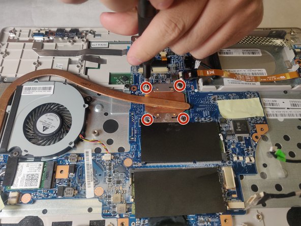

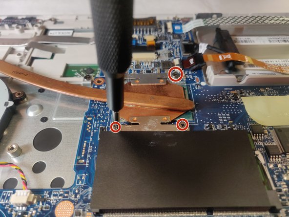

    • Unscrew screws from the CPU heat sink using the Phillips #1 screwdriver.
  11. Toshiba Satellite E45t-B4204 Keyboard  Replacement: crwdns2935265:011crwdnd2935265:01crwdnd2935265:02crwdne2935265:0 Toshiba Satellite E45t-B4204 Keyboard  Replacement: crwdns2935265:011crwdnd2935265:02crwdnd2935265:02crwdne2935265:0

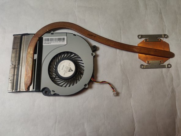

    • Unplug the wire from the motherboard.
    • Remove the heat sink.

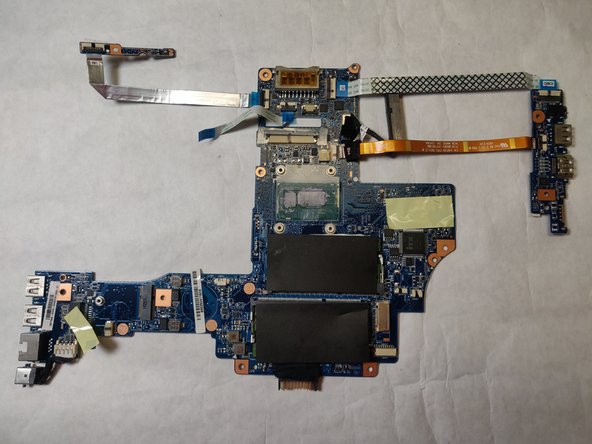

    • Unscrew the motherboard with the Phillips #1 screwdriver.

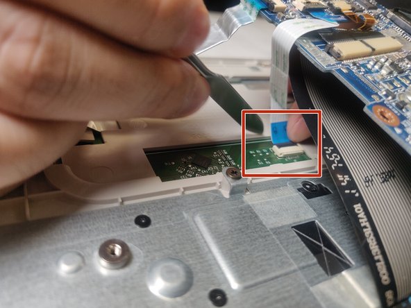

  14. Toshiba Satellite E45t-B4204 Keyboard  Replacement: crwdns2935265:014crwdnd2935265:01crwdnd2935265:03crwdne2935265:0 Toshiba Satellite E45t-B4204 Keyboard  Replacement: crwdns2935265:014crwdnd2935265:02crwdnd2935265:03crwdne2935265:0 Toshiba Satellite E45t-B4204 Keyboard  Replacement: crwdns2935265:014crwdnd2935265:03crwdnd2935265:03crwdne2935265:0
    • Remove the motherboard.

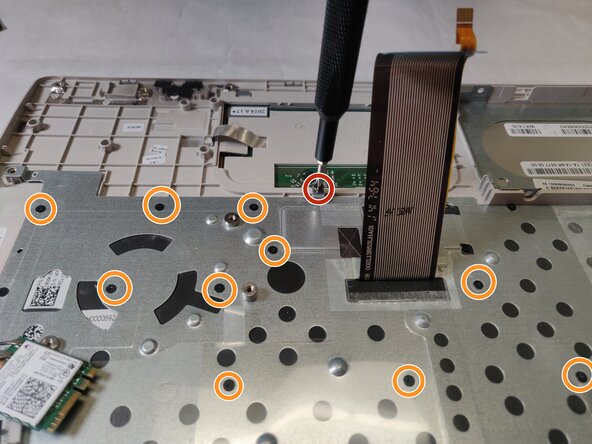

  15. Toshiba Satellite E45t-B4204 Keyboard  Replacement: crwdns2935265:015crwdnd2935265:01crwdnd2935265:03crwdne2935265:0 Toshiba Satellite E45t-B4204 Keyboard  Replacement: crwdns2935265:015crwdnd2935265:02crwdnd2935265:03crwdne2935265:0 Toshiba Satellite E45t-B4204 Keyboard  Replacement: crwdns2935265:015crwdnd2935265:03crwdnd2935265:03crwdne2935265:0

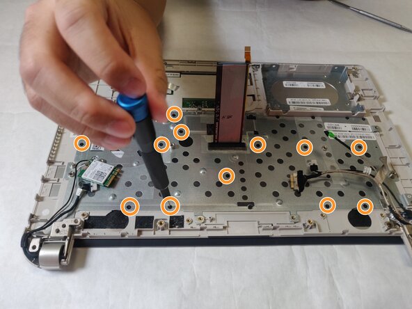

    • Unscrew the keyboard cover using the #1 screwdriver.
    • Unscrew the keyboard cover using the Phillips #0 screwdriver.
