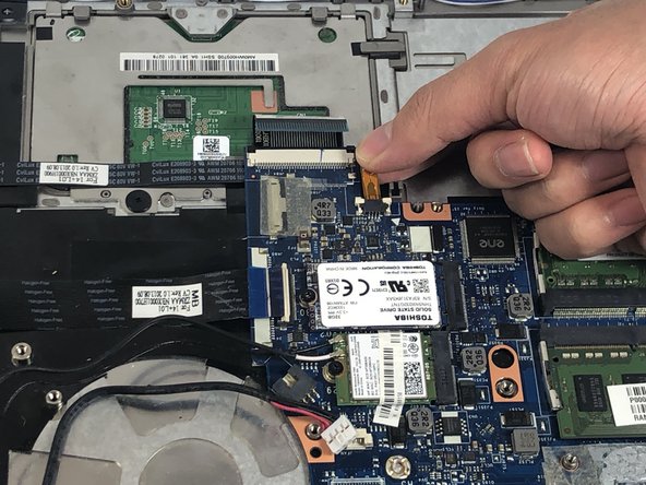

  11. Toshiba Satellite E45T-A4300 Motherboard Replacement, Battery: crwdns2935265:011crwdnd2935265:01crwdnd2935265:01crwdne2935265:0
    • Disconnect the battery connector from the motherboard.
  12. Toshiba Satellite E45T-A4300 Motherboard Replacement: crwdns2935265:012crwdnd2935265:01crwdnd2935265:01crwdne2935265:0
    • Remove the single screw Phillips #1 screw near the battery.
  13. Toshiba Satellite E45T-A4300 Motherboard Replacement: crwdns2935265:013crwdnd2935265:01crwdnd2935265:02crwdne2935265:0 Toshiba Satellite E45T-A4300 Motherboard Replacement: crwdns2935265:013crwdnd2935265:02crwdnd2935265:02crwdne2935265:0
    • Remove the battery from the laptop.
  14. Toshiba Satellite E45T-A4300 Motherboard Replacement, Motherboard: crwdns2935265:014crwdnd2935265:01crwdnd2935265:02crwdne2935265:0 Toshiba Satellite E45T-A4300 Motherboard Replacement, Motherboard: crwdns2935265:014crwdnd2935265:02crwdnd2935265:02crwdne2935265:0
    • Remove the single 7 mm silver screw using a Phillips #1 screwdriver.
  15. Toshiba Satellite E45T-A4300 Motherboard Replacement: crwdns2935265:015crwdnd2935265:01crwdnd2935265:01crwdne2935265:0
    • Pull metal stick holder until it is upright.
  16. Toshiba Satellite E45T-A4300 Motherboard Replacement: crwdns2935265:016crwdnd2935265:01crwdnd2935265:02crwdne2935265:0 Toshiba Satellite E45T-A4300 Motherboard Replacement: crwdns2935265:016crwdnd2935265:02crwdnd2935265:02crwdne2935265:0
    • Remove the 7 mm silver screw under the metal bar using the Phillips #1 screwdriver.
  17. Toshiba Satellite E45T-A4300 Motherboard Replacement: crwdns2935265:017crwdnd2935265:01crwdnd2935265:03crwdne2935265:0 Toshiba Satellite E45T-A4300 Motherboard Replacement: crwdns2935265:017crwdnd2935265:02crwdnd2935265:03crwdne2935265:0 Toshiba Satellite E45T-A4300 Motherboard Replacement: crwdns2935265:017crwdnd2935265:03crwdnd2935265:03crwdne2935265:0
    • Disconnect the six connectors from the device.
    • For the monitor port, pull it from the black tab.
    • For the connection port with the blue strip, lift the white placeholder before pulling the blue strip out of the connection port.
  18. Toshiba Satellite E45T-A4300 Motherboard Replacement: crwdns2935265:018crwdnd2935265:01crwdnd2935265:02crwdne2935265:0 Toshiba Satellite E45T-A4300 Motherboard Replacement: crwdns2935265:018crwdnd2935265:02crwdnd2935265:02crwdne2935265:0
    • Pull out 2 plugs out from the wireless network card.
  19. Toshiba Satellite E45T-A4300 Motherboard Replacement: crwdns2935265:019crwdnd2935265:01crwdnd2935265:01crwdne2935265:0
    • Remove the motherboard from the device.
