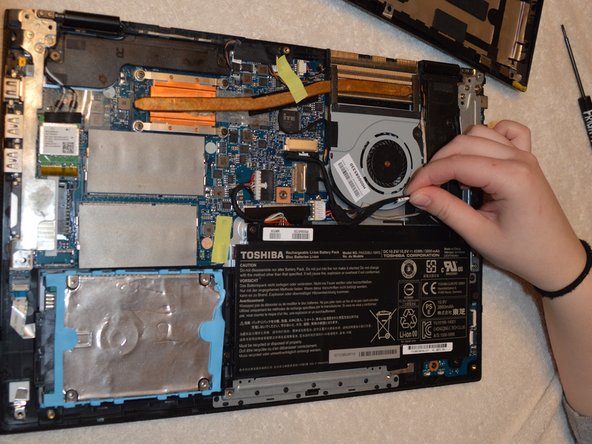

  4. Toshiba Satellite E45DW-C4210  Battery  Replacement: crwdns2935265:04crwdnd2935265:01crwdnd2935265:01crwdne2935265:0
    • Using your pointer finger and thumb grab the cords where they connect to the plug.
    • Gently pull the battery attachment from the laptop.

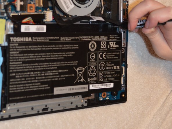

  5. Toshiba Satellite E45DW-C4210  Battery  Replacement: crwdns2935265:05crwdnd2935265:01crwdnd2935265:02crwdne2935265:0 Toshiba Satellite E45DW-C4210  Battery  Replacement: crwdns2935265:05crwdnd2935265:02crwdnd2935265:02crwdne2935265:0
    • Using the Phillips #0 screwdriver, unscrew each of the four screws holding the battery in place.
  6. Toshiba Satellite E45DW-C4210  Battery  Replacement: crwdns2935265:06crwdnd2935265:01crwdnd2935265:01crwdne2935265:0
    • Lift and remove the battery from the device.
