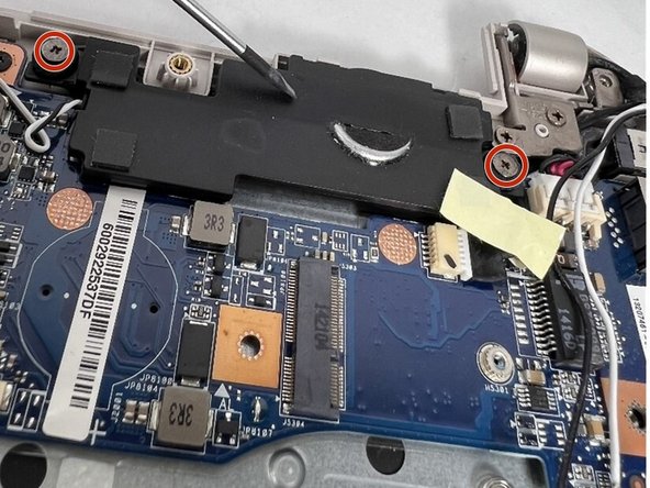

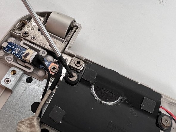

  3. Toshiba Satellite E45-B4200 Speakers Replacement: crwdns2935265:03crwdnd2935265:01crwdnd2935265:03crwdne2935265:0 Toshiba Satellite E45-B4200 Speakers Replacement: crwdns2935265:03crwdnd2935265:02crwdnd2935265:03crwdne2935265:0 Toshiba Satellite E45-B4200 Speakers Replacement: crwdns2935265:03crwdnd2935265:03crwdnd2935265:03crwdne2935265:0
    • Using a Phillips #0 screwdriver, unscrew the two screws from each speaker, that hold them in place.
    • You don't need to remove the screws, just unscrew them to the point that you're able to remove them from the device.
  4. Toshiba Satellite E45-B4200 Speakers Replacement: crwdns2935265:04crwdnd2935265:01crwdnd2935265:01crwdne2935265:0
    • Gently remove the speakers from the laptop. Make sure to disconnect the speaker wires from the frame prior to lifting the speakers out.
