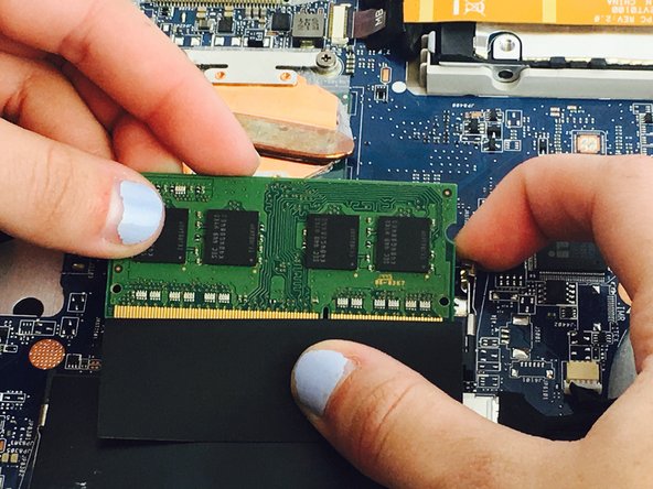

    • Remove the fourteen 3.75mm screws with a Phillips #0 Screwdriver as shown.
  2. Toshiba Satellite E45-B4100 RAM Replacement: crwdns2935265:02crwdnd2935265:01crwdnd2935265:01crwdne2935265:0
    • Gently pull out the battery.
  3. Toshiba Satellite E45-B4100 RAM Replacement, RAM: crwdns2935265:03crwdnd2935265:01crwdnd2935265:01crwdne2935265:0
    • Using a spudger, poke the white tabs in by the battery until you hear a click.
  4. Toshiba Satellite E45-B4100 RAM Replacement: crwdns2935265:04crwdnd2935265:01crwdnd2935265:02crwdne2935265:0 Toshiba Satellite E45-B4100 RAM Replacement: crwdns2935265:04crwdnd2935265:02crwdnd2935265:02crwdne2935265:0
    • Separate the laptop by sliding a spudger in between the black and silver covers.
    • Be sure to use ESD-safe tools, we recommend iFixit Toolkit.
  5. Toshiba Satellite E45-B4100 RAM Replacement: crwdns2935265:05crwdnd2935265:01crwdnd2935265:02crwdne2935265:0 Toshiba Satellite E45-B4100 RAM Replacement: crwdns2935265:05crwdnd2935265:02crwdnd2935265:02crwdne2935265:0
    • Pull the two metal brackets out away from RAM unit while simultaneously sliding the RAM unit out.
