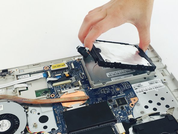

    • Remove the fourteen 3.75mm screws with a Phillips #0 Screwdriver as shown.
  2. Toshiba Satellite E45-B4100 Hard Drive Replacement: crwdns2935265:02crwdnd2935265:01crwdnd2935265:01crwdne2935265:0
    • Gently pull out the battery.
  3. Toshiba Satellite E45-B4100 Hard Drive Replacement, Hard Drive: crwdns2935265:03crwdnd2935265:01crwdnd2935265:01crwdne2935265:0
    • Using a spudger, poke the white tabs in by the battery until you hear a click.
  4. Toshiba Satellite E45-B4100 Hard Drive Replacement: crwdns2935265:04crwdnd2935265:01crwdnd2935265:02crwdne2935265:0 Toshiba Satellite E45-B4100 Hard Drive Replacement: crwdns2935265:04crwdnd2935265:02crwdnd2935265:02crwdne2935265:0

    • Unplug the Hard Drive from the Motherboard.
  6. Toshiba Satellite E45-B4100 Hard Drive Replacement: crwdns2935265:06crwdnd2935265:01crwdnd2935265:02crwdne2935265:0 Toshiba Satellite E45-B4100 Hard Drive Replacement: crwdns2935265:06crwdnd2935265:02crwdnd2935265:02crwdne2935265:0
    • Unplug both ribbons by flipping back the white tabs on either end of the ribbons and gently pulling the ribbons out.
  7. Toshiba Satellite E45-B4100 Hard Drive Replacement: crwdns2935265:07crwdnd2935265:01crwdnd2935265:02crwdne2935265:0 Toshiba Satellite E45-B4100 Hard Drive Replacement: crwdns2935265:07crwdnd2935265:02crwdnd2935265:02crwdne2935265:0
    • Using the 0 Phillips Head, unscrew the two 3.75mm screws connecting the USB Port Circuit Board to the hard drive.
    • Remove the USB Port Circuit Board.
  8. Toshiba Satellite E45-B4100 Hard Drive Replacement: crwdns2935265:08crwdnd2935265:01crwdnd2935265:02crwdne2935265:0 Toshiba Satellite E45-B4100 Hard Drive Replacement: crwdns2935265:08crwdnd2935265:02crwdnd2935265:02crwdne2935265:0
    • Gently remove the hard drive.

By and large this and the B4200 guide are interchangeable. I followed both when reviving my B4100, as the pictures the respective authors show the components from different angle. Good stuff; thank you!
