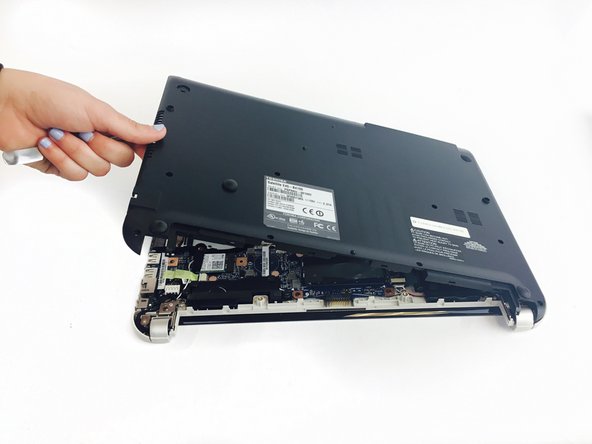

    • Separate the laptop by sliding a spudger in between the black and silver covers.
    • Be sure to use ESD safe tools, we recommend using the iFixit Pro Tech Toolkit.
