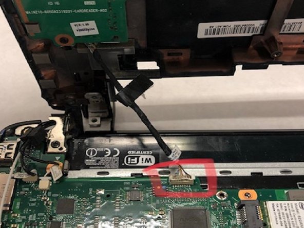

  3. Toshiba Satellite E205-S1904 Fan Replacement: crwdns2935265:03crwdnd2935265:01crwdnd2935265:01crwdne2935265:0
    • Disconnect small attached cable
    • Remove Back Panel
