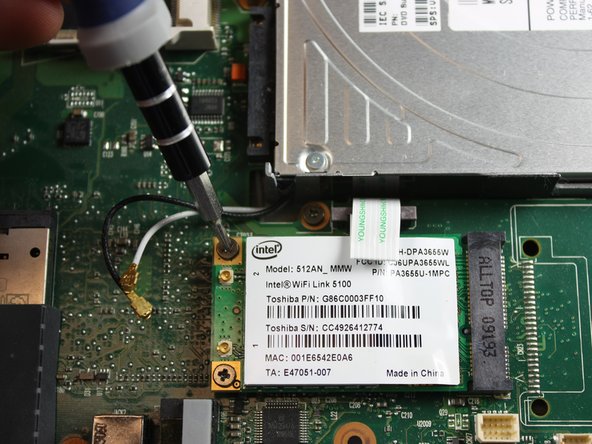

  18. Toshiba Satellite E105-S1602 Wifi Card Replacement, Wifi Card: crwdns2935265:018crwdnd2935265:01crwdnd2935265:01crwdne2935265:0
    • Locate the WiFi card, which is directly beneath the disc drive.
  19. Toshiba Satellite E105-S1602 Wifi Card Replacement: crwdns2935265:019crwdnd2935265:01crwdnd2935265:03crwdne2935265:0 Toshiba Satellite E105-S1602 Wifi Card Replacement: crwdns2935265:019crwdnd2935265:02crwdnd2935265:03crwdne2935265:0 Toshiba Satellite E105-S1602 Wifi Card Replacement: crwdns2935265:019crwdnd2935265:03crwdnd2935265:03crwdne2935265:0
    • Locate the black wire and white wire connected to the WiFi card.
    • Using a pair of tweezers remove the wires by lifting them straight up away from the board.
    • For reassembly, note that the black wire connects to the top port, and the white wire to the bottom part.
  20. Toshiba Satellite E105-S1602 Wifi Card Replacement: crwdns2935265:020crwdnd2935265:01crwdnd2935265:02crwdne2935265:0 Toshiba Satellite E105-S1602 Wifi Card Replacement: crwdns2935265:020crwdnd2935265:02crwdnd2935265:02crwdne2935265:0
    • Locate and remove the two Philips #00 4.85 mm screws on the left of the WiFi card.
  21. Toshiba Satellite E105-S1602 Wifi Card Replacement: crwdns2935265:021crwdnd2935265:01crwdnd2935265:02crwdne2935265:0 Toshiba Satellite E105-S1602 Wifi Card Replacement: crwdns2935265:021crwdnd2935265:02crwdnd2935265:02crwdne2935265:0
    • Be careful not to pull the WiFi card straight up, as you might damage components on the motherboard.
    • Grip the sides of the WiFi card and lift it up partially.
    • Gently pull the WiFi card away from the black plastic base to remove.
