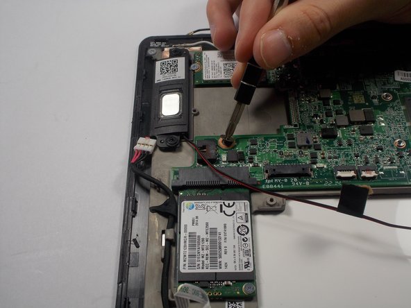

  15. Toshiba Satellite Click 2 Pro Motherboard Replacement, Motherboard: crwdns2935265:015crwdnd2935265:01crwdnd2935265:01crwdne2935265:0
    • Locate and remove the five connectors using ESD safe tweezers.
  16. Toshiba Satellite Click 2 Pro Motherboard Replacement: crwdns2935265:016crwdnd2935265:01crwdnd2935265:02crwdne2935265:0 Toshiba Satellite Click 2 Pro Motherboard Replacement: crwdns2935265:016crwdnd2935265:02crwdnd2935265:02crwdne2935265:0
    • Remove the four 3.0mm Phillips J0 screws using a Phillips screw driver.
  17. Toshiba Satellite Click 2 Pro Motherboard Replacement: crwdns2935265:017crwdnd2935265:01crwdnd2935265:01crwdne2935265:0
    • Remove the motherboard.
