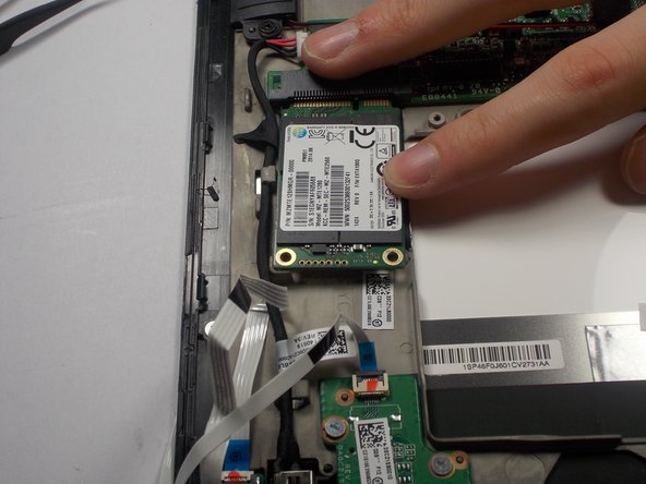

  8. Toshiba Satellite Click 2 Pro Hard Drive  Replacement, Hard Drive: crwdns2935265:08crwdnd2935265:01crwdnd2935265:02crwdne2935265:0 Toshiba Satellite Click 2 Pro Hard Drive  Replacement, Hard Drive: crwdns2935265:08crwdnd2935265:02crwdnd2935265:02crwdne2935265:0
    • Remove the two screws using a J0 Phillips screw driver
  9. Toshiba Satellite Click 2 Pro Hard Drive  Replacement: crwdns2935265:09crwdnd2935265:01crwdnd2935265:01crwdne2935265:0
    • Remove the hard drive
