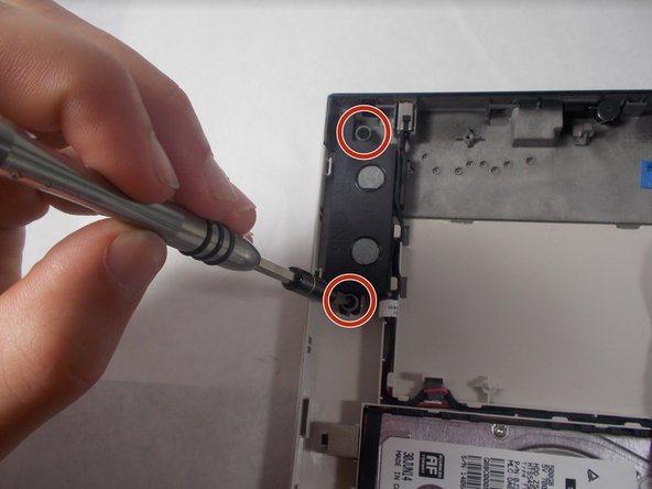

  9. Toshiba Satellite Click 2 L35W-B3204 Speaker Replacement, Speaker: crwdns2935265:09crwdnd2935265:01crwdnd2935265:02crwdne2935265:0 Toshiba Satellite Click 2 L35W-B3204 Speaker Replacement, Speaker: crwdns2935265:09crwdnd2935265:02crwdnd2935265:02crwdne2935265:0
    • Identify the speakers on the upper left and right side of the inside of the device.
    • Using a Phillips 0 screwdriver, unscrew the two screws in each speaker.
  10. Toshiba Satellite Click 2 L35W-B3204 Speaker Replacement: crwdns2935265:010crwdnd2935265:01crwdnd2935265:01crwdne2935265:0
    • Using tweezers, unclip the speaker's wires from the device's motherboard.
  11. Toshiba Satellite Click 2 L35W-B3204 Speaker Replacement: crwdns2935265:011crwdnd2935265:01crwdnd2935265:01crwdne2935265:0
    • Carefully unhook the wires connecting the speakers from the hooks that hold them.
  12. Toshiba Satellite Click 2 L35W-B3204 Speaker Replacement: crwdns2935265:012crwdnd2935265:01crwdnd2935265:01crwdne2935265:0
    • The speakers are now fully removed from the device.
