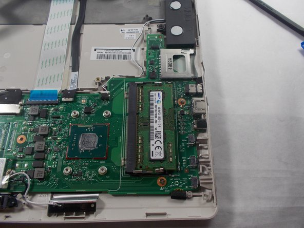

    • Locate the metal cover that is protecting the RAM. It can easily be found in the corner (placed on top of the mother board).
    • Then remove the two pieces of tape towards the edge of the cover.
  10. Toshiba Satellite Click 2 L35W-B3204 RAM Card Replacement: crwdns2935265:010crwdnd2935265:01crwdnd2935265:02crwdne2935265:0 Toshiba Satellite Click 2 L35W-B3204 RAM Card Replacement: crwdns2935265:010crwdnd2935265:02crwdnd2935265:02crwdne2935265:0
    • Using a plastic opening tool, find your way between the cover and motherboard.
    • Lift the plastic opening tool to unfasten the metal cover.
  11. Toshiba Satellite Click 2 L35W-B3204 RAM Card Replacement: crwdns2935265:011crwdnd2935265:01crwdnd2935265:02crwdne2935265:0 Toshiba Satellite Click 2 L35W-B3204 RAM Card Replacement: crwdns2935265:011crwdnd2935265:02crwdnd2935265:02crwdne2935265:0

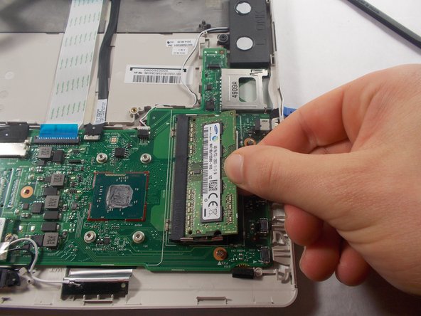

    • Use a plastic opening tool to slightly lift the RAM card itself.
    • Gently unplug the RAM from its slot.
  12. Toshiba Satellite Click 2 L35W-B3204 RAM Card Replacement: crwdns2935265:012crwdnd2935265:01crwdnd2935265:01crwdne2935265:0
    • Congratulations! You have safely removed your RAM Card.
