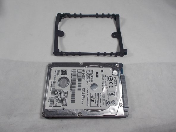

  9. Toshiba Satellite Click 2 L35W-B3204 Hard Drive Replacement, Hard Drive: crwdns2935265:09crwdnd2935265:01crwdnd2935265:01crwdne2935265:0
    • Locate the hard drive in the bottom left of the panel.
  10. Toshiba Satellite Click 2 L35W-B3204 Hard Drive Replacement: crwdns2935265:010crwdnd2935265:01crwdnd2935265:01crwdne2935265:0
    • Remove the hard drive using a plastic opening tool.
  11. Toshiba Satellite Click 2 L35W-B3204 Hard Drive Replacement: crwdns2935265:011crwdnd2935265:01crwdnd2935265:01crwdne2935265:0
    • Lift up and unclip the hard drive using the opening tool to pull the plug out.
  12. Toshiba Satellite Click 2 L35W-B3204 Hard Drive Replacement: crwdns2935265:012crwdnd2935265:01crwdnd2935265:02crwdne2935265:0 Toshiba Satellite Click 2 L35W-B3204 Hard Drive Replacement: crwdns2935265:012crwdnd2935265:02crwdnd2935265:02crwdne2935265:0
    • Remove the hard drive from its rubber housing.
