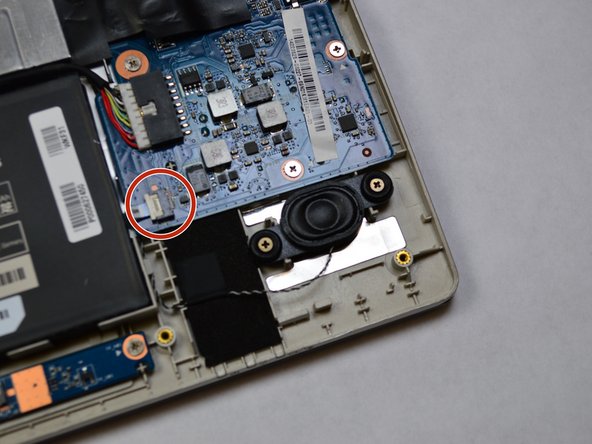

  7. Toshiba Satellite CL15t-B1204X  Speaker Replacement, Speaker: crwdns2935265:07crwdnd2935265:01crwdnd2935265:02crwdne2935265:0 Toshiba Satellite CL15t-B1204X  Speaker Replacement, Speaker: crwdns2935265:07crwdnd2935265:02crwdnd2935265:02crwdne2935265:0
    • Carefully unplug the speaker's cord from the I/O board.
  8. Toshiba Satellite CL15t-B1204X  Speaker Replacement: crwdns2935265:08crwdnd2935265:01crwdnd2935265:02crwdne2935265:0 Toshiba Satellite CL15t-B1204X  Speaker Replacement: crwdns2935265:08crwdnd2935265:02crwdnd2935265:02crwdne2935265:0
    • Unscrew the two 3mm screws with the PH1 screw head on each speaker found on the corner's away from the hinges.
