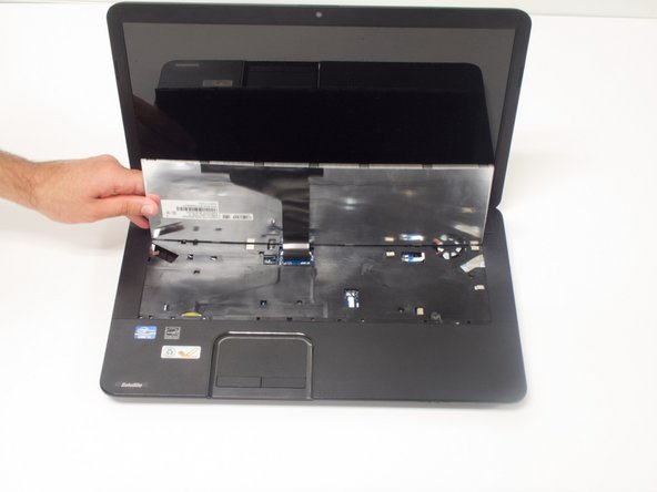

  7. Toshiba Satellite C875-S7304 Motherboard Replacement: crwdns2935265:07crwdnd2935265:01crwdnd2935265:02crwdne2935265:0 Toshiba Satellite C875-S7304 Motherboard Replacement: crwdns2935265:07crwdnd2935265:02crwdnd2935265:02crwdne2935265:0

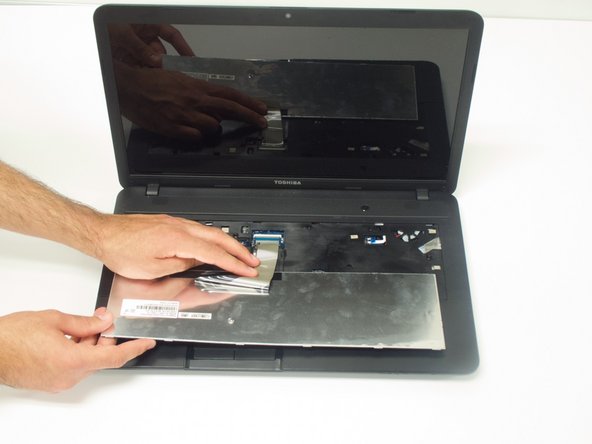

    • Using the iFixit opening tool, carefully remove the black plastic bar below the keyboard.
  8. Toshiba Satellite C875-S7304 Motherboard Replacement: crwdns2935265:08crwdnd2935265:01crwdnd2935265:03crwdne2935265:0 Toshiba Satellite C875-S7304 Motherboard Replacement: crwdns2935265:08crwdnd2935265:02crwdnd2935265:03crwdne2935265:0 Toshiba Satellite C875-S7304 Motherboard Replacement: crwdns2935265:08crwdnd2935265:03crwdnd2935265:03crwdne2935265:0
    • Pry the keyboard up and apart from the device.
    • Disconnect the ribbon cable under the keyboard.

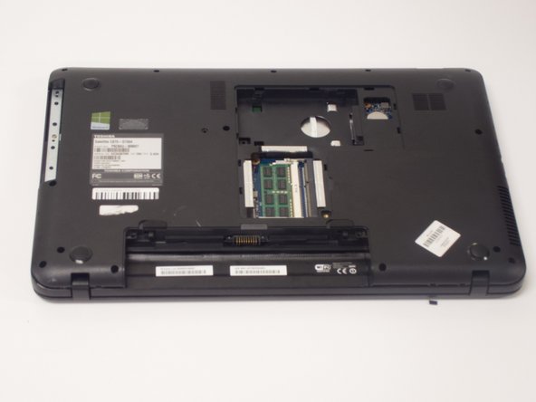

    • Use a Phillips #1 to unscrew one 7.0 mm screw from the hard drive/RAM panel and remove panel.
    • Slide the hard drive laterally first and then lift the hard drive up using the clear tab.
    • You cannot remove the screw from the panel. Simply unscrew it until loosened.
  12. Toshiba Satellite C875-S7304 Motherboard Replacement: crwdns2935265:012crwdnd2935265:01crwdnd2935265:01crwdne2935265:0
    • Use a Phillips #1 to remove all 15 of the screws holding the bottom panel intact.

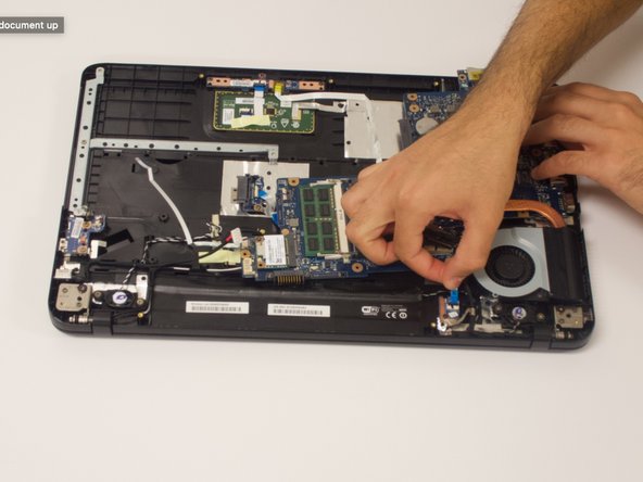

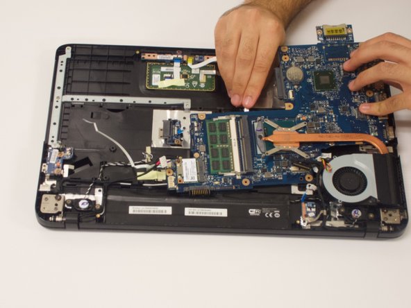

  15. Toshiba Satellite C875-S7304 Motherboard Replacement: crwdns2935265:015crwdnd2935265:01crwdnd2935265:03crwdne2935265:0 Toshiba Satellite C875-S7304 Motherboard Replacement: crwdns2935265:015crwdnd2935265:02crwdnd2935265:03crwdne2935265:0 Toshiba Satellite C875-S7304 Motherboard Replacement: crwdns2935265:015crwdnd2935265:03crwdnd2935265:03crwdne2935265:0
    • Remove all wiring from the motherboard and pry it from the device slowly making sure that no ribbons or wires are connected.
  16. Toshiba Satellite C875-S7304 Motherboard Replacement: crwdns2935265:016crwdnd2935265:01crwdnd2935265:01crwdne2935265:0
    • Gently remove the motherboard from inside the device. You are now ready to replace the motherboard.
