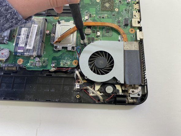

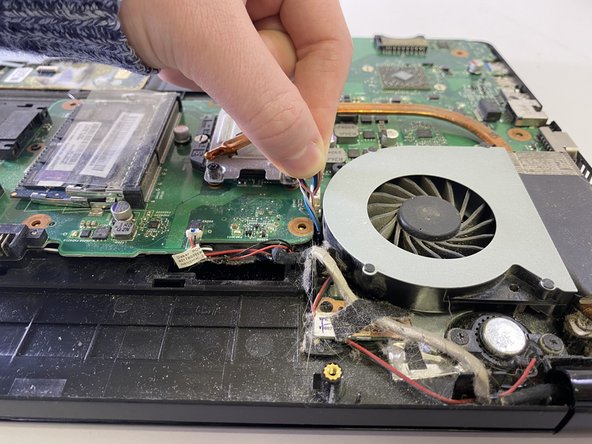

    • The cooling fan is in the bottom right corner of the laptop.
    • Unplug the small red and blue wire connecting the cooling fan to the motherboard.
    • Remove the two 3 mm screws securing the fan to the motherboard with a Phillips #00 screwdriver.
    • Remove the fan from the laptop.
