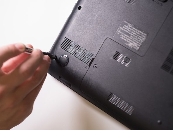

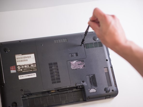

  3. Toshiba Satellite C855-S5115 Cooling Fan Replacement, Cooling Fan: crwdns2935265:03crwdnd2935265:01crwdnd2935265:02crwdne2935265:0 Toshiba Satellite C855-S5115 Cooling Fan Replacement, Cooling Fan: crwdns2935265:03crwdnd2935265:02crwdnd2935265:02crwdne2935265:0
    • Remove the ten 7mm Phillips screws located on the bottom of the laptop using the Phillips #1 screwdriver.
  4. Toshiba Satellite C855-S5115 Cooling Fan Replacement: crwdns2935265:04crwdnd2935265:01crwdnd2935265:02crwdne2935265:0 Toshiba Satellite C855-S5115 Cooling Fan Replacement: crwdns2935265:04crwdnd2935265:02crwdnd2935265:02crwdne2935265:0
    • Remove the 7mm Phillips screw located on the easy access panel on the bottom of the laptop using a Phillips #1 screwdriver.

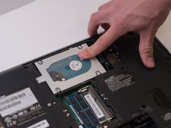

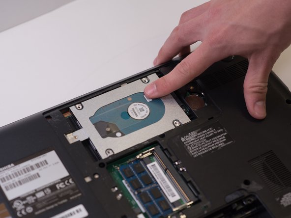

  7. Toshiba Satellite C855-S5115 Cooling Fan Replacement: crwdns2935265:07crwdnd2935265:01crwdnd2935265:03crwdne2935265:0 Toshiba Satellite C855-S5115 Cooling Fan Replacement: crwdns2935265:07crwdnd2935265:02crwdnd2935265:03crwdne2935265:0 Toshiba Satellite C855-S5115 Cooling Fan Replacement: crwdns2935265:07crwdnd2935265:03crwdnd2935265:03crwdne2935265:0
    • Remove the 3mm Phillips #1 screw holding the HDD in place, then slide the HDD towards the sticker.
  8. Toshiba Satellite C855-S5115 Cooling Fan Replacement: crwdns2935265:08crwdnd2935265:01crwdnd2935265:01crwdne2935265:0
    • Pull the HDD out.
