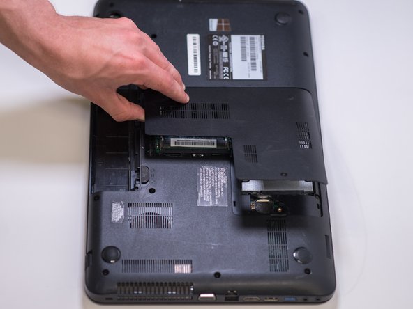

    • Use two fingers to pull the ridged lock tabs on the bottom of the computer toward the edges. This will unlock the battery.
  2. Toshiba Satellite C855-S5115 CMOS Battery Replacement: crwdns2935265:02crwdnd2935265:01crwdnd2935265:01crwdne2935265:0
    • Holding the left tab in place, use the groove located between the two tabs to pry the battery up and out.
  3. Toshiba Satellite C855-S5115 CMOS Battery Replacement, CMOS Battery: crwdns2935265:03crwdnd2935265:01crwdnd2935265:01crwdne2935265:0
    • Remove the 7mm screw from the back panel using the Phillips head screwdriver.
  4. Toshiba Satellite C855-S5115 CMOS Battery Replacement: crwdns2935265:04crwdnd2935265:01crwdnd2935265:02crwdne2935265:0 Toshiba Satellite C855-S5115 CMOS Battery Replacement: crwdns2935265:04crwdnd2935265:02crwdnd2935265:02crwdne2935265:0
    • Use the spudger to pry the back panel out of the laptop.
  5. Toshiba Satellite C855-S5115 CMOS Battery Replacement: crwdns2935265:05crwdnd2935265:01crwdnd2935265:02crwdne2935265:0 Toshiba Satellite C855-S5115 CMOS Battery Replacement: crwdns2935265:05crwdnd2935265:02crwdnd2935265:02crwdne2935265:0
    • Push the pin that holds the CMOS battery in place downwards. The battery will then come out.
