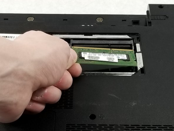

  4. Toshiba Satellite C675-S7106 RAM Replacement: crwdns2935265:04crwdnd2935265:01crwdnd2935265:02crwdne2935265:0 Toshiba Satellite C675-S7106 RAM Replacement: crwdns2935265:04crwdnd2935265:02crwdnd2935265:02crwdne2935265:0
    • Unclip and move the two metal clips on either side of one or either RAM stick.
    • Pull the stick outwards as you lift it upwards.
    • When reinstalling, ensure that the contacts are completely covered and connected.
