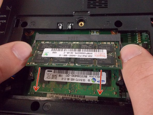

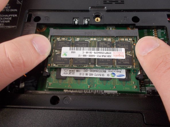

    • To remove the RAM sticks, put your thumbs on the metal pins and push outwards.
    • Once pushed outwards, the first RAM stick will pop up at an angle
    • After the RAM is at an angle, you can now remove that stick of RAM and repeat the process to the second stick of RAM.
