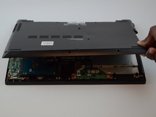

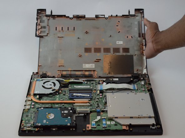

    • Run the metal spudger around the seam between the back cover and the rest of the laptop.
  4. Toshiba Satellite C55D-C5106 RAM Replacement: crwdns2935265:04crwdnd2935265:01crwdnd2935265:03crwdne2935265:0 Toshiba Satellite C55D-C5106 RAM Replacement: crwdns2935265:04crwdnd2935265:02crwdnd2935265:03crwdne2935265:0 Toshiba Satellite C55D-C5106 RAM Replacement: crwdns2935265:04crwdnd2935265:03crwdnd2935265:03crwdne2935265:0
    • Use the metal spudger to remove the bottom cover of the laptop.

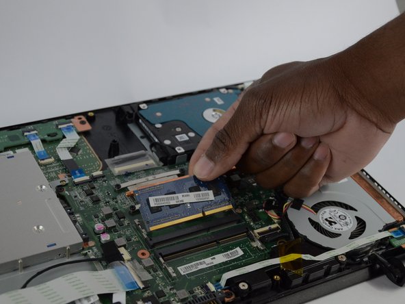

  5. Toshiba Satellite C55D-C5106 RAM Replacement: crwdns2935265:05crwdnd2935265:01crwdnd2935265:02crwdne2935265:0 Toshiba Satellite C55D-C5106 RAM Replacement: crwdns2935265:05crwdnd2935265:02crwdnd2935265:02crwdne2935265:0
    • Pull out the clips securing the RAM chip.
    • Remove the RAM chip.
