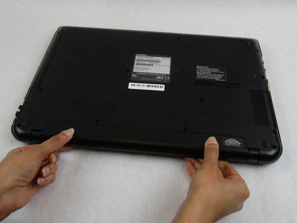

    • Turn off your laptop before starting.
    • Flip the laptop over so the model stickers face the ceiling.
