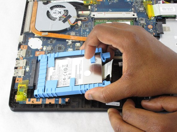

  10. Toshiba Satellite C55D-B5310 Keyboard Replacement, Keyboard: crwdns2935265:010crwdnd2935265:01crwdnd2935265:03crwdne2935265:0 Toshiba Satellite C55D-B5310 Keyboard Replacement, Keyboard: crwdns2935265:010crwdnd2935265:02crwdnd2935265:03crwdne2935265:0 Toshiba Satellite C55D-B5310 Keyboard Replacement, Keyboard: crwdns2935265:010crwdnd2935265:03crwdnd2935265:03crwdne2935265:0
    • Using the ribbon beneath the hard drive lift it upwards and pull the hard drive out.
