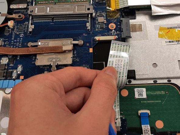

  6. Toshiba Satellite C55D-B5206 Trackpad Replacement, Trackpad: crwdns2935265:06crwdnd2935265:01crwdnd2935265:01crwdne2935265:0
    • Use a non-metallic object to remove the yellow polyimide tape that covers the trackpad connector.
  7. Toshiba Satellite C55D-B5206 Trackpad Replacement: crwdns2935265:07crwdnd2935265:01crwdnd2935265:01crwdne2935265:0
    • Use a non-metallic object to lift up the gray ZIF tab on trackpad connector.
    • Gently pull the blue ribbon cable free.
