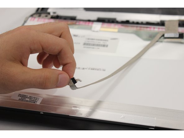

    • Gently pull the screen downward to separate the screen from the back screen casing.
    • Gently grasp the cable that was removed from the camera and lift this cable upward.
    • There will be some tape that peels as you remove this cable from the back of the screen.

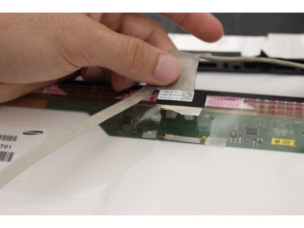

  12. Toshiba Satellite C55D-B5206 Screen Replacement: crwdns2935265:012crwdnd2935265:01crwdnd2935265:02crwdne2935265:0 Toshiba Satellite C55D-B5206 Screen Replacement: crwdns2935265:012crwdnd2935265:02crwdnd2935265:02crwdne2935265:0
    • Grip the large end of the brown cable.
    • Peel off the beige colored tape. Do not worry about ripping this tape.
    • Detach the black connector from the screen.
